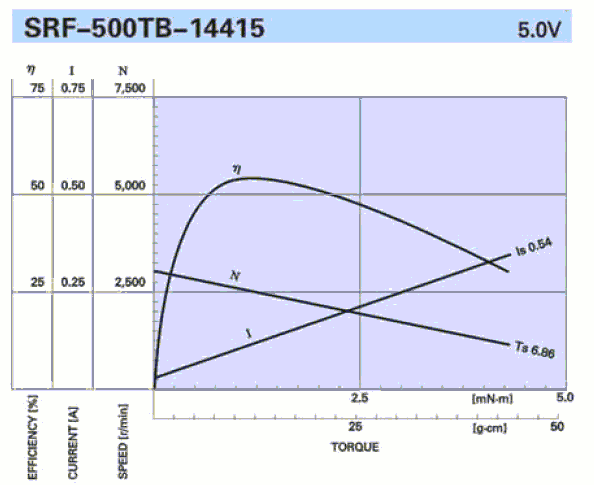

Here is the problem. You're saying that η=P(out)/P(in) is twice at 50% load as at full load. That part just doesn't hold true.
As for synchronizing two motors, I've thought about that when I had a stash of motors that were about half of the output I needed. The way to combine the outputs is to use a differential, similar to the rear axle of a car. Each motor would connect to the "axel shafts" and output taken from the "drive shaft" ( sorry for the terminology, but I don't know a better way to state it ) The output would then be the average of each motor's speed, and the power would add.
Boncuk,
You're talking about AC motors, this thread is about DC motors.
Anyway, it's not true, the current is directly proportional to the torque.
Attached is a graph from one of the DC data sheets I linked to previously.
