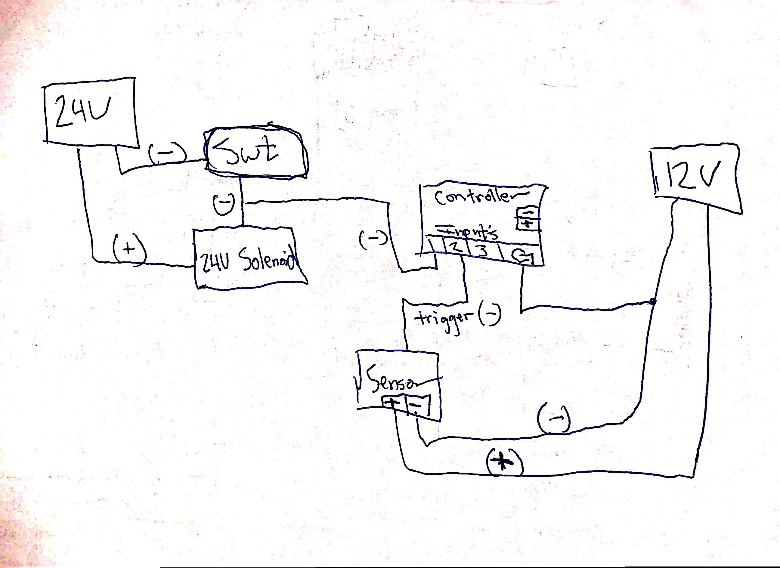

Im trying to use one end point switch to drive two seperate DC sources. One is a 24V dc power supply ground hooked up and I want to use that ground wire to trigger a controller that is powered from a completely seperate dc power source. Is this bad practice or will it work? Can I connect both ground wires from each source to the same switch without issues?

I want the 24v volt to send a ground signal to the controller when the switch is activated. The controller has a ground input so I’m guessing that ground needs to be the same grounds as the inputs being triggered.

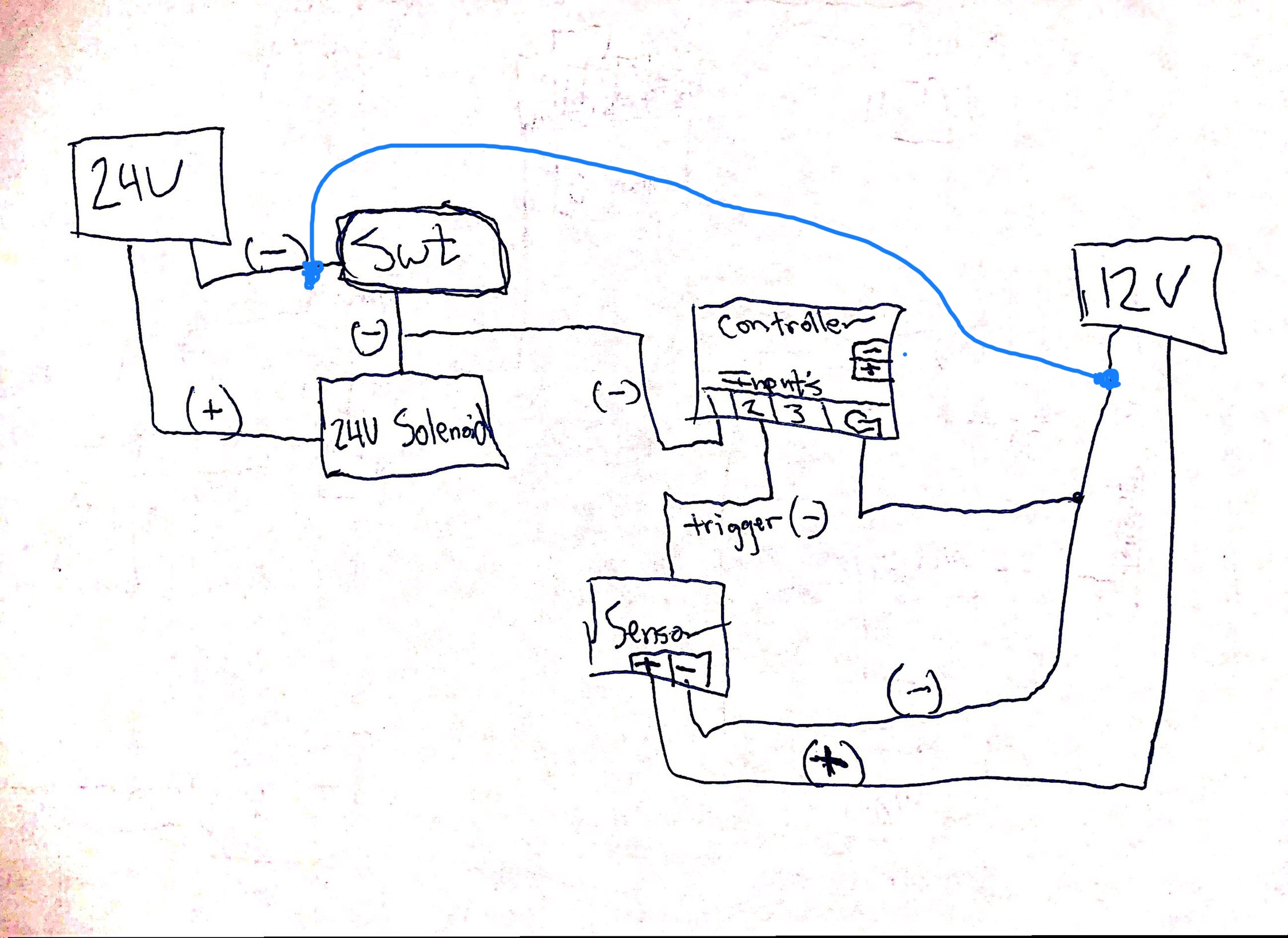

I think this should do it.
The solenoid is Essentially a pull-up resistor for the switch.
You need to make sure your 12v controller can accommodate a 24v signal.
Also, I don't see a +12v to power your controller in the schematic.
