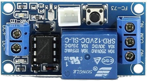

I have a bunch of X10 modules (first image) like in picture and thought I would put them to use.
With some electronic devices plugged in, the modules would turn on by themselves after being shut off.
On one computer plugged into them, it turns on and then shuts off repeating this over and over about every thirty seconds.
Others have expressed this about other systems such as in second image.
To correct this problem, I added a double pole relay to the power circuit following the module to disconnect both line and neutral. This seems to work.
Three things I can think of:
1. Why does this happen?
2. Since there still seems to be a connection in the off mode (not to mention the added energy consumption of the module itself), are we really saving any power?
3. Other solutions?

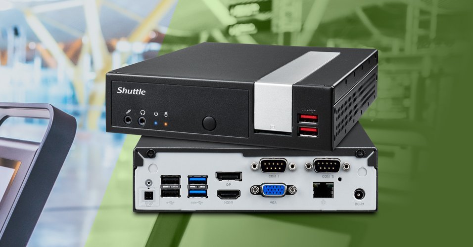

The replacement dedicated homeseer machine I've just got direct from them ("HomeTroller PRO") is based on a Shuttle DL20, custom badged and with homeseer pro pre-installed. Whilst it was on the black friday offer, it was cheaper than the same hardware from elsewhere, plus windows & the HS4 licence. It came with Windows 10 & auto boots into the homeseer system.
Note the similarity!

At 110/120 Vac, the coil current is around 10 to 11 mA, considerably more than the TRIAC leakage current. In terms of system energy, it uses the same energy in 1 hour of on time as the leakage power during 10 hours of off time.
In my conclusions, a latching relay is what is really needed in these remote switching devices. I know of none that have them. Also, my disconnecting of the neutral, though maybe good, serves no real purpose.
For good reason, it would be a VERY serious safety issue - as following a power cut the device has no way of knowing what position the relay might be in.
X10 modules seem to retain their state after a power cut. There is an audible click when they switch. Yet, it has all the signs of leakage. For lack of better knowledge on my part, I intend to change to latching devices even if I have to build them myself.
One is possibly using these:
HiLetgo 12V Single Bistable Self-Locking Relay Module Push to Start and Stop
The drawback for me is they are not remote or wirelessly controlled. I would have to add that circuitry. I could hard wire them but making them wireless (Preferred) is beyond my scope of learning.
Here is another possibility:
ELECTRONICS-SALON Panel Mount Momentary-Switch/Pulse-Signal Control Latching SPDT Relay Module,12V​
They also have a two relay version if you want to do neutral as well (also preferred).
The relay itself is not latching. It restores it's previous state after power is restored.
