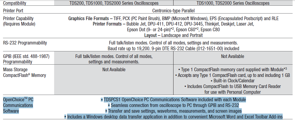

I don't know if you can get real time real time views on the PC. You need to look at the "Open Choice software".
