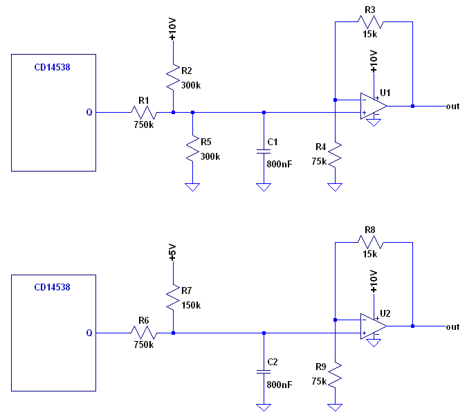

I am beginner student of electronics.....How to obtain constant dc output voltage between 5 to 6volt?????by converting frequency varying between 0-10kHz using frequency to voltage converter...also tell me is there monostable multivibrator in circuit???....i have attached figure....pls suggest me modifications in circuit as per my requirment....can i modify switch which will be closed automatically if the output is not in specified range???.....

He wants a F to V converter, which would output a voltage in the range of 5 volts when 10 Khz are applied. And he is asking what component changes are required in the monostable and outputs filters to do so.

@ scmitt trigger,yes u r right....in my above fig,output varies between 0 to Vcc(dc)...i want output in range of 5-6 Volt..for range 0 to 10khz input...pls suggest me changes....
Your transfer function is Vout=(Vin/5) + 5. You can do this with some op amps and resistors.

You could do it either of the two ways shown in the attachment. Use an op amp with low bias current inputs, like TL071, or a CMOS op amp.
EDIT: You can do it without an op amp if you don't need low output impedance, but I'm going to bed now.
What supply voltage do you have available that is higher than +5V?

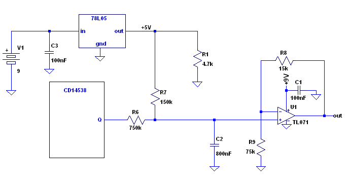

i found this another attached circuit on net.....pls tell me about modifications in this circuit....if i want to obtain 5-6 volts output,which parameters r required to change....also is there any formula relating output voltage with other parameters in circuit?????9 volts battery is availble to me...if i connect that battery to Vs in fig.....which parameters shud i change?????

Here's how to do it with a 9V supply.
You can use the +5V to power the CD14538 also.

THANK U...very much for ur circuit.....now at last ;pls clear 1 doubt,will the above circuit give me constant output between 5-6 volts?????for frequency varying between 20hz-20khz????if not pls suggest me formula relating output voltage in amplifier with other parameters such as resistors or capacitors....thanks in advance....
