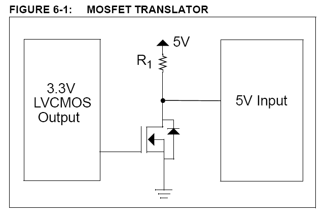

Continue with the demultiplexer...circuit attached
Thanks for the explain. And what kind of pull-down-transistor should I use?
I would use small MOSFET rather than BJT. Just make sure MOSFET gate is designed to completely turn on with gate voltage of your MCU (2.5V or 3.3V). As long as datasheet gives on-resistance at a voltage that is 2.5V to 3.3V MCU can turn it on (do not look at gate threshold voltage on datasheet since this is voltage that just "barely" turns on MOSFET). Otherwise you will experience same problem as before...MCU output HI is not high enough. Also make sure MOSFET can tolerate at least 12V across source-drain since it needs to block this voltage when it is off.

At last... thats why the 4067 is not being addressed.
The MCU 3.3V high, is not seen as a High by the 4067.!

You need to have a voltage higher than about 6V for the address inputs of the 4067 to be 'seen' as high.
A level shifter is required.

The MCU i/o can output voltage as high as 5.7v, if I follow the datasheet, I need to shift from at least 5v to 10v. is that right? it's for the high level, the low level should shift from 0v to 5v
Low level is fine because any input voltage below LO threshold is understood as LO by demux. LO threshold increase with supply voltage so no problem there since you are always below LO threshold. LO signal from MCU will be read as LO signal by demux.
The problem is the high output voltage because increasing supply voltage increase HI voltage threshold, but input voltage must be higher than threshold to be read as HI.
My pull-up resistor and pull-down transistor is a level shifter and should solve your problem.

Address voltage level inversion.

One thing you should know about my solution...the level-shifter is actually a level-shifting INVERTER.
So if MCU send LO to level-shifter, level-shifter will send HI to demux. If MCU send HI to level-shifter, level-shifterwill send LO to demux. You can easily deal with this in code.

Dk, I seem to remember you posted a real good appnote for level translation awhile back. Do you remember the link?
