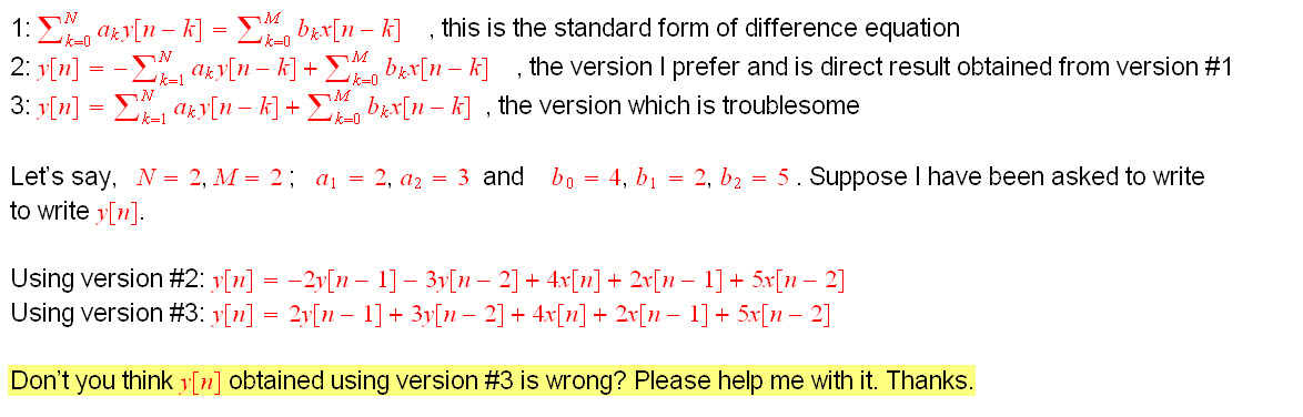

I don't really get it. Please have a look here. Thanks.
Regards
PG
So, the difference between 2 and 3 is the negative sign on the a_k coefficients. These definitions for a_k are different with one definition being the negative of the other definition. You can't say one is correct and the other is wrong. You can only decide on which definition you prefer, and once you decide, don't change definitions later. I just opened up one of my books which uses your definition #2. I can't recall if all books use this definition, but I believe this is the most common form. But, just be careful to check the definition used in your reference.

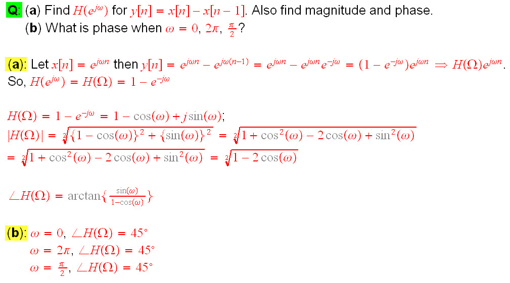

Could you please check it to see if my working is completely correct? Thank you.
Could you please also help me with this query? Thanks.

I think there is an error in part B. The phase should be 90 degrees for w=0 and 2pi. If you take the limit of sin(w)/(1-cos(w)), you get a x/x^2 form which goes to infinity as x goes to zero. The arctan of infinity is 90 degrees.
The other question I would say consult whatever book you are using for the definitions. You may find one notation used for the standard FT and the other for the DFT, but don't guess, - look at the context you are in or look at the definitions to be sure.
Could you please tell me how you get x/x^2? Thanks.
Yes, you are right in saying that some books might use H(e^jw) for DTFT and H(Ω) for DFT. Thanks.
Regards
PG
Well, there are many ways to take limits, but one way is by Taylor expansion.
If we expand sin(w) and take the lowest order term, we get x, and if we expand cos(w) to two lowest order terms we get 1-x^2/2.
So, this will actually give 2/x for the ratio sin(w)/(1-cos(w)) which becomes infinity as w goes to zero, and then arctan gives 90 degrees.
You may have been confused by the factor of 2 that I was missing before. I just did it quickly in my head and ignored the factor because infinity or 2 times infinity is the same thing.
Thank you. I get it now.

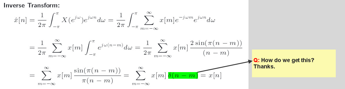

The sine of a multiple of pi is zero. Hence sin(pi(n-m))/(pi(n-m)) is zero for any m and n where n is not equal to m. When n equals m, we have a 0/0 limit to evaluate, but we know that the limit of sin(x)/x is 1 as x goes to zero. Hence, this function is an shifted impulse function as shown.
