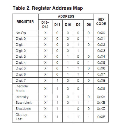

The addresses for the 7219 are its Digit location address.
The 'sample' code I posted is for an EEPROM which requires the 0x02 and 0x06 codes to command the EEPROM to perform a certain internal action.
The 7219 will required this type of internal Command instruction, they are listed in the d/sheet.
Check the d/s for the required code and use SPISend.
E

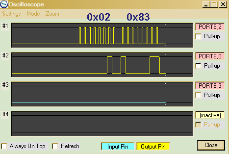

Hello,
Here's a piece of testcode. It doesn't work yet. I'm still investigating to a solution, but reply's at the code are very welcome..
'PIC 16F628A, with 16Mhz crystal and pull ups (10k) at SDI and CLK
'This program has to energize led 0,1 and 7 of row 2 at a 8x8 ledmatrix (rownumbers numbered 1..8)
Define CONF_WORD = 0x3f42
AllDigital
Define CLOCK_FREQUENCY = 16
Define SPI_CS_REG = PORTB
Define SPI_CS_BIT = 1
Define SPI_SCK_REG = PORTB  'with pull up (10k)
Define SPI_SCK_BIT = 2
Define SPI_SDI_REG = PORTB  'with pull up (10k)
Define SPI_SDI_BIT = 0
Define SPI_SDO_REG = PORTB
Define SPI_SDO_BIT = 3
SPIPrepare
'Init MAX7219
SPICSOn
SPISend 12  'Registeradress shutdown
SPISend 1  'value written To registry
SPICSOff
WaitMs 10
SPICSOn
SPISend 9  'Registeradress decode mode
SPISend 0  'value written to registry
SPICSOff
WaitMs 10
SPICSOn
SPISend 11  'Registeradress scanlimit
SPISend 7  'value written to registry
SPICSOff
WaitMs 10
SPICSOn
SPISend 10  'Registeradress intensity
SPISend 1  'value written to registry
SPICSOff
WaitMs 10
SPICSOn
SPISend 15  'Registeradress testmode/ normal mode
SPICSOff
WaitMs 10
'End of init
main:
SPICSOn
SPISend 0x02  'Registeradress (digit 1)
SPISend 131  'bit 0, 1 and 7 for test
SPICSOff
WaitMs 10
Goto main
'End of mainprogram
Best regards,
Reijnko

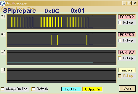

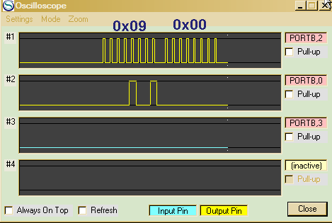

Looks OK to me.:D
Three images of the scope,, image3 is the 'main' loop
Eric
The registers on that chip are odd.... Really odd
Data
D7 D6 D5 D4 D3 D2 D1 D0
Segments
DP..A...B...C...D...E...F...G..
So to write 131 as you did
01100001.. Which is 0x61 or 97 decimal
If you turn decode on ( 0xff ) then if you write 2 then it displays 2
