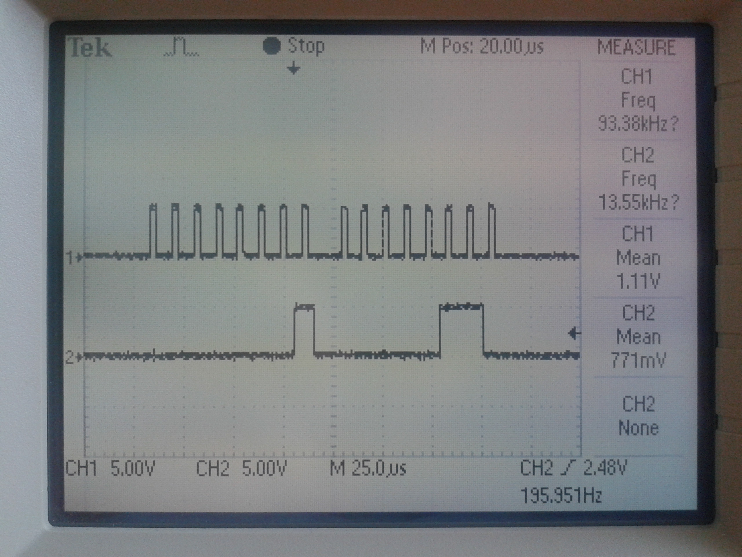

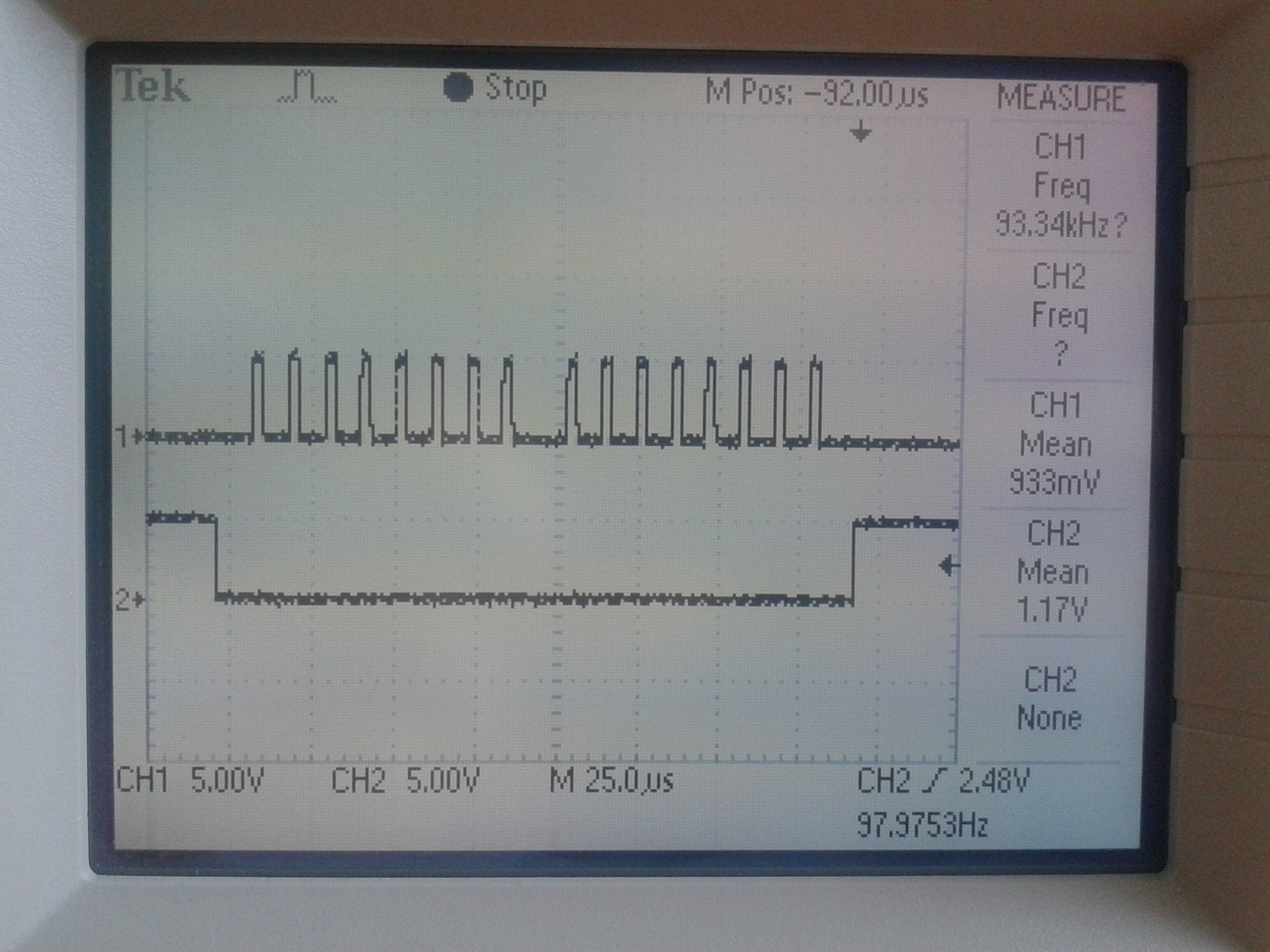

At this moment i am a little bit further.
For the test i have conected a 7-segment display instead of a led-matrix.
The only thing that is working now is the test mode. Other commands are not working. I've changed the program a little bit, including the initialisation. I've attached the new code and two images of the SPI communication. The signals are containing some noise.
'PIC 16F628A, with 16Mhz crystal and pull ups (10k) at SDI and CLK

Here is an image of the CLK and SDI measurement:
And here is an image of the CLK and LOAD measurement:
After startup (power on) the display is showing a number or a wrong character (after each startup a different number or character).
Placing a capacitor near by the MAX7219 doesn't have any effect..
I have found in the past that 10K is too high a value, try 3k3.
E.
Hi E,
I've changed the resistors to 3k3, but it doesn't have any effect.
The strange thing is that when i turn displaytest to 1 at the init the display light up all the segments. That means to me that SPI is working correctly..

I have just run your program in Oshonsoft using a ext module for an SPI EEPROM, I can see all the program data bytes being load into the registers OK.
Have you double checked the initialise command codes for accuracy.

I've picked up the project again and i changed the MAX7219 for a MAX7221, which is fully SPI compatible .
It works fine now. I don't know why the MAX7219 doesn't work....
Thanks for all the reply's!
