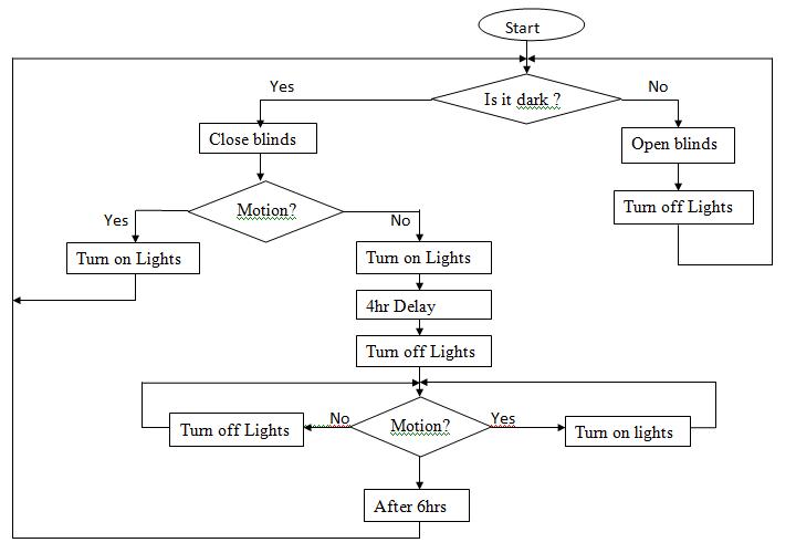

Can any one help me by correcting this code i have written
;PROGRAM FUNCTION:light control for smart home

or modify it for me so that it follows the flowchart on the attachment. I wrote the above code following the flowchart but it seems like i have made so many mistakes. for closing and opening of blinds i used unipolar stepper motor. For turning on and off lights i used LEDs and i used LDR to detect light and infrared photo detector (rs: 2017729) to detect motion
