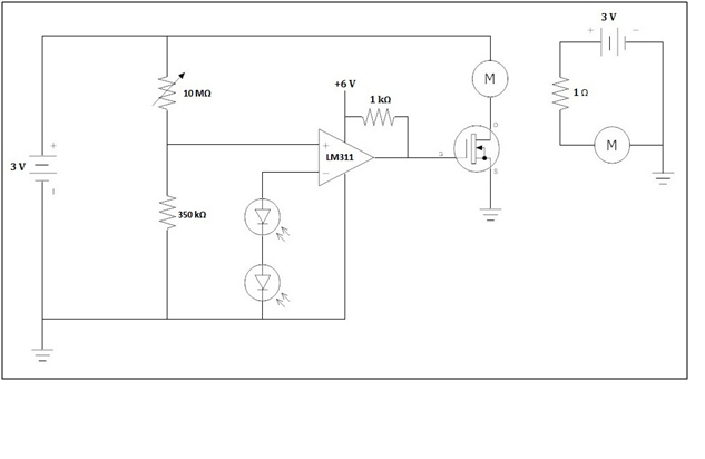

Currently, I have a decent range (3 to 5 m) remote using a couple of IR LEDs and a photodiode on the device acting as a receptor: I'm using it in photovoltaic mode, comparing the output voltage of the photodiode to a preset voltage (through an opamp), and when the voltage of the photodiode raises above the fixed one, it turns one motor off... But the other one is currently independent of the circuitry which annoys me...

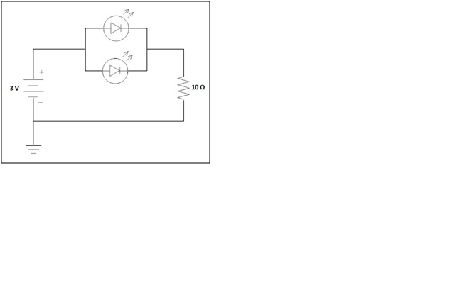

Here's the circuit diagram and the remote control diagram.
It's pretty basic...
First pic shows both motors, which run off independent battery cells.

Nice simple contro.
