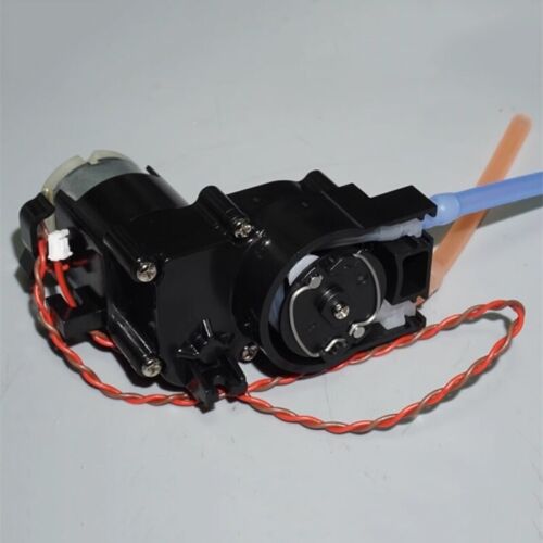

Thanks for the great info, guys! It seems to me that a combination of Arduino Uno, an MCP23017 I2C port expander, 12 humidity sensors, 12 peristaltic 5v pumps and a cell phone charger (and some ULN2003 stepper motor driver boards?) would be an elegant and inexpensive solution. I would then not have to deal with solenoid valves or relays, which would make the project easier and cheaper.
I'm looking at a peristaltic pump that draws 450 mA at 5 V, for a flow rate of 130 mL/min. Powering it all with a 5 VDC 1 A regular cell phone charger should be possible, I assume.

How much water do you need to pump? The startup current for the first and third pump may be too great for the ULN2003 to handle. The second pump lists a current of 200mA, so the 500mA limit of the '2003 gives you some headroom. The 2nd pump is rated for 148mL per minute.
If that flow rate isn't great enough, you have a couple options:
● Use N-channel MOSFETs instead of the ULN2003s.
● Use higher voltage pumps (which should use less current for higher flow rates.
Both the ULN2003 and N-channel MOSFETs switch the LOW side of the load to GROUND. The 5V output of an Arduino can control either type device to switch loads of higher voltage (50 volts or more). The complication of this approach is powering the Ardunio. A linear regulator dropping 12 volts to 5 volts dissipates a lot of heat. Switching 7805 regulator replacements are available pretty cheaply, as are switching buck converter modules.

I'd go with one of the black ones - they look to be the same item from different sellers? Those appear better made and more likely to be serviceable, such as replacing the pump tube. The white one looks to be glued together.
If you are not bothered about LEDs, you could use octal darlington modules, they are cheaper. You could parallel two channels for each motor, so still four per module.
(Also on amazon & ebay etc).
A 1A supply may be OK for the motors, though the starting current is likely a lot higher than the running current, for a fraction of a second.
I'd be wary of running the MCU on the same supply, unless you feed it via a diode and large capacitor to prevent the voltage being pulled down as a motor starts up.
rjenkinsgb , do you think the ULN2003 (rated for 500mA) provides enough margin for the pump which is rated at 450mA? I'm a bit concerned about starting current exceeding the '2003 spec. Considering the pump isn't pumping against pressure, it might be ok.
That's why I suggested the eight channel board, with two parallel channels for each relay - it gives much better protection against start up surges.
With only a 1A power supply, there cannot be more than 1 or possibly two pumps running at a time, so the drivers should be OK with that.
