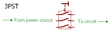

Hi, i would like to enquire some basic electronic questions.
If i want to control 3 different circuit with a single switch is it possible?
As because i am using 3 different power source for 3 different circuit, I just need a single switch either to turn them off all together or turn them on all together. Is there any recommendation available?
Similar to Colin's recommendation here's a link to a bunch of 3PST (3 pole, single throw) switches:
Toggle Switches
A 3PDT or 4PDT would work for you too, you'd just have a few extra/unnecessary connections.
This picture shows basically what's going on inside a 3PST switch:
I don't know how much current the circuits you are tunring on will draw. Most of these switchs will carry 15A or more.
