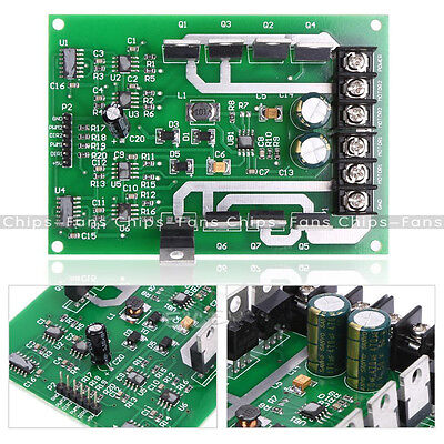

So how would I connect the IRF520/540 V2.0 MOSFET Switch Modul L9110S Stepper Dual Motor Driver 10/15A to a Arduino board and if you could please dumb it down as far as you can for me..
Could you also give me an example of a script to send to the Arduino board after its all connected together…
Reading your initial post I didn't see any mention of a need to reverse the motor rotation or any need to have speed control. Do you need either of those features? The board mentioned is actually designed to support two motors but should also support a single motor. The screw terminals allow for connection to Power and Motor 1 and Motor 2. The board also has several pins which allow for your control lines like run and stop as well as a PWM (Pulse Width Modulation) pin which would be for speed control. The board will also just run a motor in one direction at maximum speed if that is what you want. While I don't see a data sheet for the module generally for a fixed rotation direction the Motor1 screw terminals go to Motor1 the power screw terminals to your battery or power source. The DIR1 (Direction1) pin would be tied to a fixed high or low for a single direction and the PWM pin would get a digital high (run) or a digital low (stop) signal from your micro-controller, in this case your Arduino. This is a pure guess as I don't see a data sheet for the module.

I'll help you with the module.
The screw terminal side you'd connect power & gnd direct to your battery, via a fuse or breaker.
Then connect your motor to motor1 & 2.
The other side of the module with the 0.1" socket you'd connect +5v to the arduino's +5v pin, and gnd to the arduino gnd.
Then connect Dir1 to one of the arduino's digital i/o pins such as i/o 2, and connect Pwm to one of the arduino's Pwm pins.
Then use digitalwrite(dir pin) to control direction, and analogwrite(Pwmpin) to control speed.
Ground Dir2 & Pwm2, and leave motor2 outputs unconnected (unless you want 2 motors).
Using a relay if you only need start/stop is also possible, though possibly not much cheaper, work out the prices yourself.
Noise or voltage fluctuations might be an issue as Rons said, if your using a car battery and you use seperate power wires for the 'duino and motor driver module you might get away with it.

Is this looking right so far to power both boards if so can someone explain how the Arduino board would best be wired to the IRF520/540 V2.0 MOSFET Switch Modul if anyone could take the pic and add the extra wires for me or fix anything that would help out a lot thank you for all the help so far you guys are great...
The board with the pot isnt necessary, speed can be controlled with analog write from the 'duino.
Im sorry if Im making this difficult for anyone trying to help me but with my mental disability I need to see how the wires go to understand it....
Connect the output of the H bridge direct to the motor, delete the board with the switch/pot.
And connect i/o 3 on the arduino to Pwm1 on the H bridge.
Perhaps I was overcomplicating it, I was thinking of if you wanted speed control do that within the arduino, possibly with a pot, as the H bridge module is able, or designed to do that.
Your uniquegoods motor speed controller is only rated for 3 Amps. Yes, it is also rated for 80 watts, but it will only handle that much load power at 28 Volts, not 12.
I was also thinking the same. I assumed the Arduino would control the motor speed maybe with just a simple external pot since the actual motor controller can be driven with a PWM signal from the Arduino.
Which is another very good point. You may wish to rethink that through.
