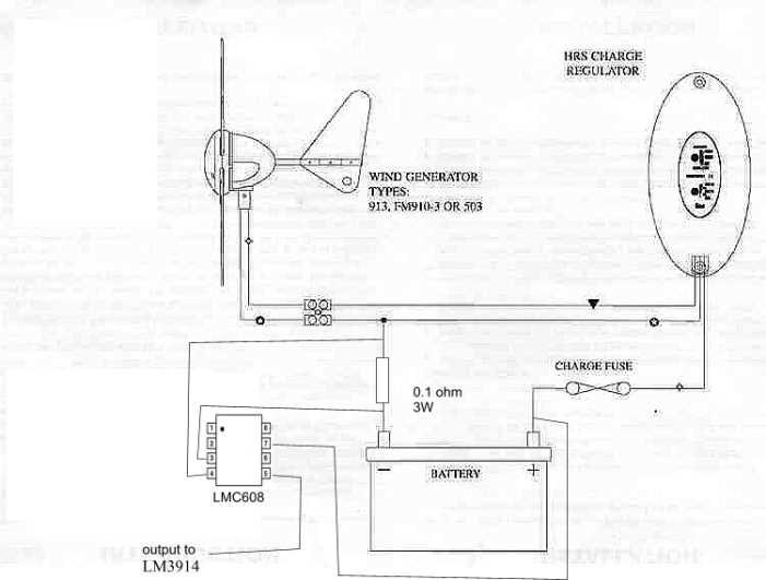

Here is a diagram of the basic circuit I'm working with; The charging current into the 12V battery from the turbine rises from 0A @ a windspeed of 5 knots to 5A @ 40 knots;

A 0.1 ohm, 1W resistor connected in series with the battery negative terminal would give 0.5V at 5 amps current. Use the battery negative terminal for your circuit common. Amplify the resistor voltage with a non-inverting op amp connection set for a gain of 10 to give 5V at a 5A current to the LM3914.
For ease of design use a rail-rail type op amp such as a National LMC6081IN or TI TLV2450CP which allows the use of a single power supply.
Thanks very much! I wish that I had found this site years ago!
I miscalculated. It should be a 0.1Ω 3W resistor. The resistor power at 5A is 2.5W.

Hi - sorry I've been missing for a while - I've tried to understand crutschow's advice about the ground/common and where to tap off readings. I have a 12V battery and want to use it to power the chips I'm supposed to be using (an op amp and led driver). Can it really be that simple?
Anyway, attached is what I think crutschow was trying to say!

hi Dave.
I will post a circuit during the weekend, dont buy any bits till you see it.
The power for the op amp/LM3914 and leds will come from the 12V battery thats being charged.
Q. Do you power other equipment from the 12V battery while its on charge or is it just a battery charger.? ie: whats the battery used for.?
You dont need rail to rail op amps for this application.

If the clock requires very little power as most quartz clocks do, then we can make a simple 1.5Vdc take off point from the battery
Eventually the battery will also be used to power a small solid state computer and monitor so that the school can show a presentation on alternative energy and what the kids are doing
That should not be a problem
One thought occurs to me - if I am monitoring a voltage drop produced at a particular current, what effect will the regulator have as the battery becomes charged?
If you mean the wind gen charger, you are not monitoring at a particular current. The LM3914 will light upto 10 Leds, one for every 0.5A of charging current.
