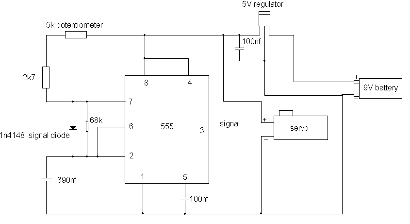

im feeding the 5V regulator with 9V, the schematic is the same as blueroomelectronics servo pulser on page1, exept im using a 5V regulator, i dont know how to put the schematic on these pages anyway, can i just draw it up in ms paint and upload it???
Yep, although for line art PNG is better.
here is the way i have mine set up, can you find anything wrong with it???

The ordinary 5V regulator needs an input of 7.5V or more. The 9V battery voltage will quickly drop to 7.2V which is too low. Then the 555 and servo are starved of voltage.
Use a "low dropout" 5V regulator. It is made by all semiconductor manufacturers and still works hine when its input voltage is 5.4V.
The ordinary 555 produces supply current spikes of 400mA when its output switches. Then it drags down the voltage of the 9V battery so the servo is starved of voltage.
Connect a 100uF capacitor across the 9V and 0V terminals on the circuit board to supply momentary current when the 555 switches.
A Cmos 555 like an LMC555, TLC555 or ICL7555 produces a much lower supply current spike.

How about a generic 5 cell battery pack? The servo can get it's power directly from the battery and the 555 can get it's power from the regulator. You may need to use a low dropout regulator though. The tweaking was probably because caused when the servo draw enough current to drop the voltage down bellow the regulators dropout and the 555 started to oscilate with the servo pulses.
