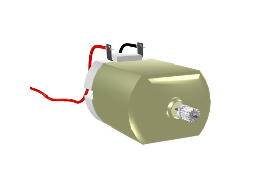

mates, how can we control a reversible motor of its rotation? im using this kind of motor
AMPdeck said:
like id like to rotate for only 90 degrees?
Not easy with a DC motor, you would need to gear it down substanially, then have some kind of sensor to detect it's position (possibly as simple as a limit switch?).
This sort of application is probably more suited to a stepper or servo, depending what you are trying to do?.
