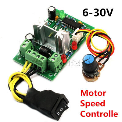

A few of these?
That has speed control on the pot and the switch for reversing.
The direct reversing switch could be replaced by a different style or by a relay, controlled by another type of switch.

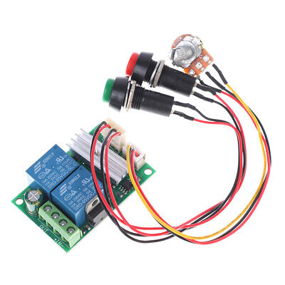

Another type with built-in reversing relays, so one button for each direction by the look of it:
Forward and reverse within a joystyick makes it rather more complex; definitely possible but it will then involve either fairly complex built-up electronics or a microcontroller plus slightly less complex electronics.

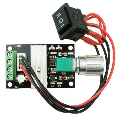

Thanks for the speedy response and suggestions! Now that I have an idea of what to look for, I'm thinking of using something like this:

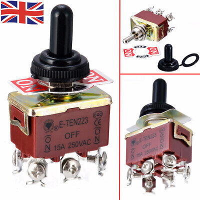

Since both the switch and speed control are on wires, it would be easier for me to mount them in the controller I intend to build. I'm also thinking to replace the switch with a three position toggle, that returns to the neutral position by itself (if that's a thing).
Depending on power requirements, model servos may be the way to go.
Indeed - this is the first example I found:
