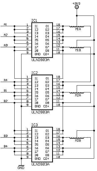

It is unipolar stepper motors. I was i bit conserned about the fact that the motors is 1a, but i'm having some trouble finding 1a drivers for the stepper motors. Is there any way that I could connect two drivers in parallel to get the 1a current rating for the motors?

Hi evergreen1,
one transistor of the array can sink 500mA. If you parallel 3 inputs and outputs they will sink 1.5A. per 3 transistors.
Driving two steppers you'll need 3 pcs. ULN2803 not to exceed the max allowed current.
The TI data sheet says nothing about the total power dissipation of one chip.
Since outputs are not active at the same time I'd give it a try.
Boncuk
