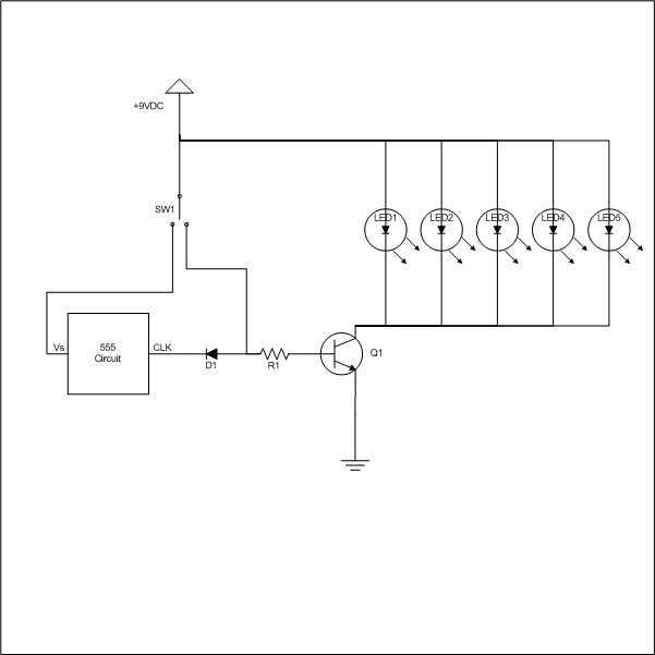

I have this good idea for once, and I can't figure out how to do it. I want a string of LEDs, about 10 LEDs, to blink. I want to be able to control how fast using a knob of some kind. I want to be able to turn the knob to 0 and they just stay lit. When it's at 10, they are going really fast. I really suck at this whole electronics thing. I can get the LEDs to come on with a battery, but that's pretty much it. What do I need to make them blink, and where does the knob come in at? I know I will need the LEDs (any certain kind?) and a knob, but what else I should get?

The best way to do this is to build a 555 timer circuit with one of the resistors as a potentiometer. I can't think of what some values you would use might be, but try this. First of all you want your 555 to operate in a mode called astable, where it switches on and off at the output. There are a ton of 555 timer calculators on the Internet, find one where you can supply the frequency and duty cycle (this should be around 63%) and calculate the resistor and capacitor values for the lowest speed you want, and the highest speed you want. Then buy a potentiometer that has a range about within those values. Then build the circuit to drive your lights. You will need to use an NPN transistor to pwoer the LEDs off the timer though, because of the current draw. Connect the timer's oscilating output to the base of an NPN transistor with a resistor (lets say 1K Ohm, but this will vary depending on your supply voltage), then wire your supply voltage to the positive of all your LEDs, and wire the collector of the transisor to the negative on all the LEDs. Finally wire the emitter of the transistor to ground. If your 555 oscilates in the frequency range you want, this should be all you need to do.

First of all, the oscilator will do just that, oscilate. If you want the lights to have a constant on mode, build a switch into the circuit that is configured as shown below, which will switch power from the oscilating circuit to the LEDs directly. You can even get a potentiometer (the knob) that has a SPDT switch built in, thus the "knob" will click at the end of its turn cycle and will switch to solid mode.
Start your project by building a 555 timer to blink one LED as a fixed rate. You won't need a transistor to drive one LED, and you won't need any knobs. Then build on the project as you learn.
In my diagram, you see how you can switch from blinking to solid. D1 is any common switching diode, there are usually available at Radio Shack in bundles of 50 for only a few dollars. This is important here to keep the 555's CLK pin from being driven high when you switch to solid mode. R1 is a resistor that will lower the voltage that you are applying to the base of the transistor to less than the differential threshold to switch the transistor. This is important because if the voltage at the base and at the collector are the same, or the base is higher, the transistor will not let current flow from the collector to the emmiter (and you might let the smoke out too :D )
Hmm now that I look at it I think all the LEDs in my diagram are backwards, anyway just put them in so that their positives are connected to your power supply and the negatives to the transistor (or ground if you are building a circuit without the transistor).
Learn more about the 555 circuit and build a circuit with just a single blinking light. Then try replacing one of the resistors with a potentiometer (which is the "knob", it's a resistor whose resistance value is adjusted depending on how far the knob is turned). This will take some experimentation to get results that suit what you want. The 555 is an easy to find chip that you can get at Radio Shack. They also sell boxes of NPN transistors. (There are two types, NPN will allow current flow when there is voltage at the base, and PNP, which will stop current flow when there is a voltage at the base.)
After you figure out your 555 timer, build a circuit with many LEDs that you can drive with a transistor. If something smells funny, don't use that transistor again :D . Once you get those two circuits working, just combine them! Allright, well, good luck!

I left out the drop resistors in the digram too. For a plain old LED with a 9v supply, you will prolly need a resitor before each LED with a value of about 470 Ohm to 1KOhm. Again, this is dependant on the LED, just play with what gives you the birghtest LED output without getting the resistors real super hot.
