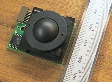

Here is a project that shows how to use a mini TrackBall to control stuff with a PIC etc.
For the moment it just uses the TrackBall X and Y values to control the colour and brightness of a RGB led, to make a test of a "Mood Light".
The trackballs are very cheap from a surplus reseller and have 2 rotary quadrature encoders one for X and one for Y. Not bad in a little neat package a little over an inch! :)
I'm considering a future project that uses a trackball on a bench PSU to control volts and amps, and would also appreciate any other ideas for projects using a TrackBall as i bought quite a few while they're cheap. ;)
TrackBall RGB led moodlight project;
TrackBall Interfacing - TrackBall to PIC microcontroller

Thanks Michael, yeah it's a very hard ball so I don't think it would work as a castor, it needs your grippy finger to work even though it turns nice and smooth.

Hehe. Thanks kchriste I didn't think of drawing or games! That's actually a 4x20 text LCD but I do have some 128x64 and 240x128 GLCDs here. I think a games setup would be way too much work but the waveform idea might be ok... Maybe even generating a waveform direct with the trackball controlling freq and amplitude, or even controlling freq and PWM? That would be handy for designing SMPS supplies.
