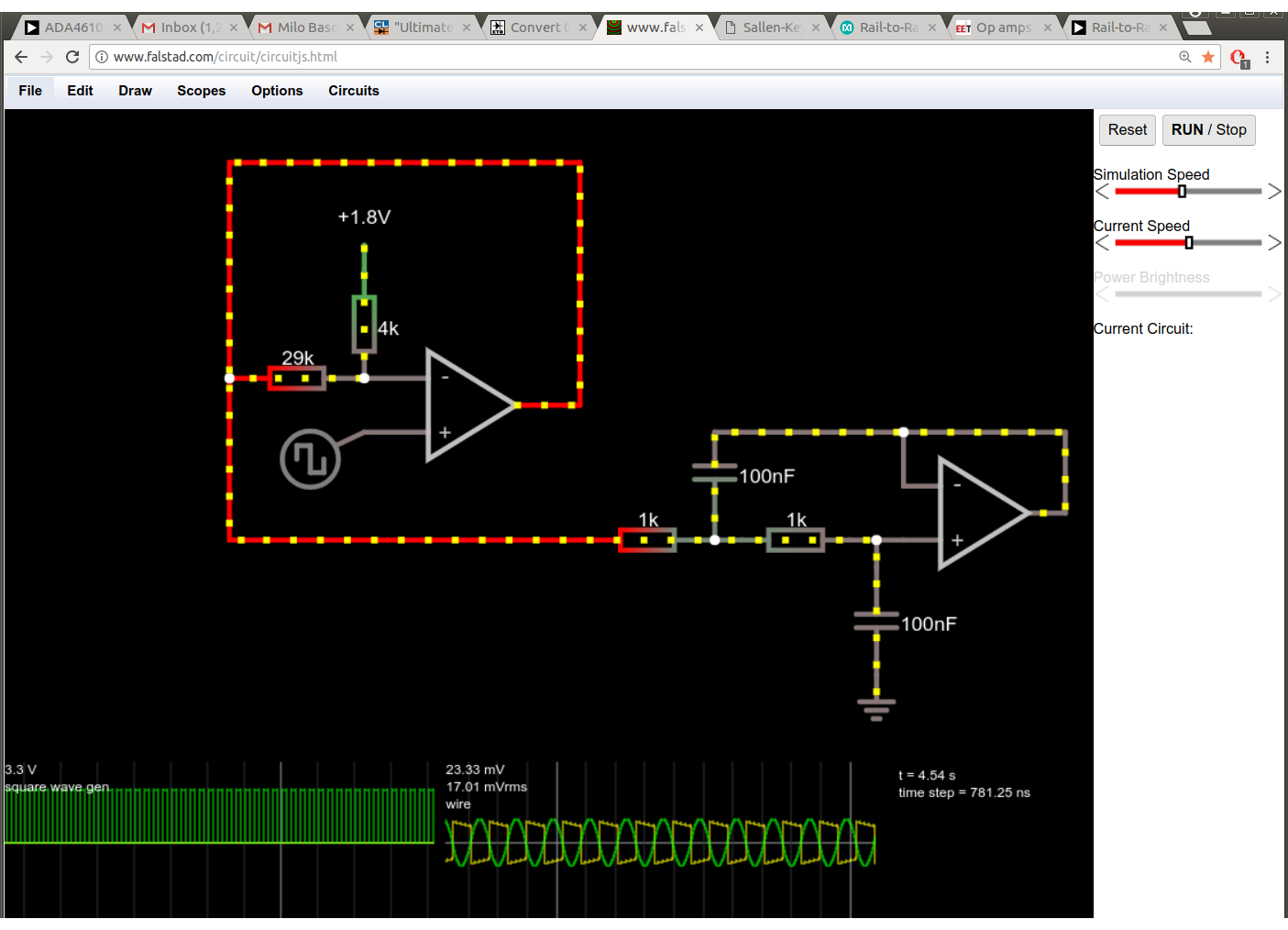

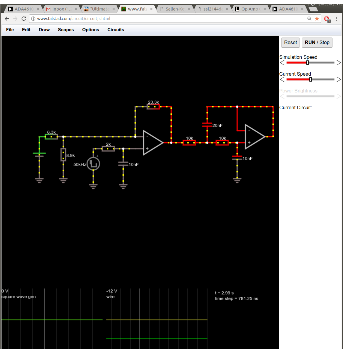

Ahh it seems they get within a couple of mV so I think I'll go with this circuit which give me reasonable noise of 17mV. I'm glad i can use an op-amp thanks for your help.
Unless you can see a way of doing this to get a cleaner signal with the same number of stages.

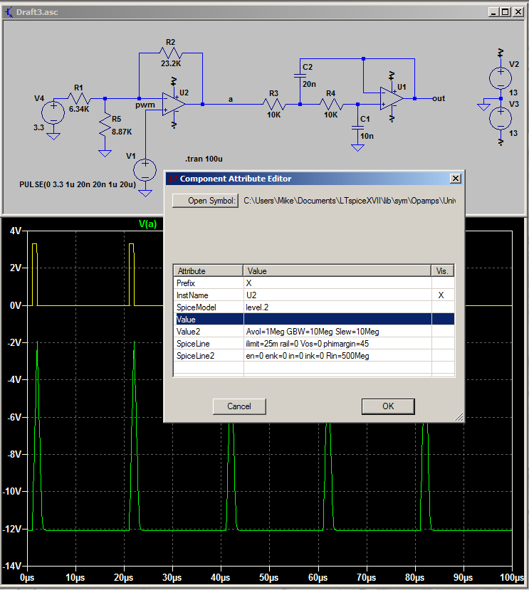

Forget the LPF for a moment. The basic gain/offset stage has some problems. Where are you going to get a 1.8V reference? Second, the gain R2/R1 is too high, causing you to saturate the output of U2. See V(a). Is that what you intended?
Note that to expose the saturation at U2, I temporarily made the supply voltages +-13V!
It's intended to control a voltage-controlled-filter. I made the gain a little too high to ensure I reach -12v. The reference was most likely going to be a trimpot divider between 3.3 and 0v.
In an ideal world I'd like a circuit that could output -12v when the PWM duty cycle is 0% sitting at 0v and only go high when PWM is active. This would avoid having to have an accurate centrepoint.

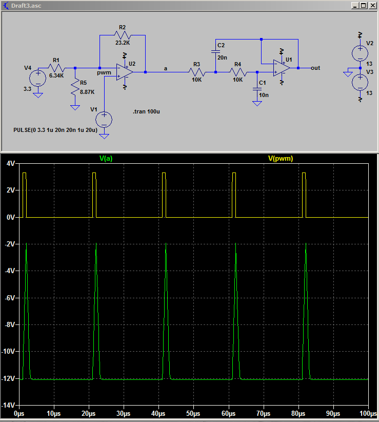

Here is a version with the gain/offset stage with different values, and a different method of getting the offset. I tweaked your filter values a bit, too.
This shows another problem. If the PWM duty cycle is small, the slew rate of the amplifier prevents it going from rail to rail, and the "filtered" average will not be what you think it should be...

On my original circuit I neglected to show there was a one-pole RC with a 7KHz cutoff prior to the op-amp.
So with Mike's modification this is where I'm at.
I'm using this basic circuit simulator just to get and understanding as it's quicker than Qucs for someone like me (all generic parts).

Oh sorry I meant the PWM, is at 50KHz to be above well above audio frequencies. I'd like to be able to get up to 20KHz out post filtering on the +/12v signal but I assume I'd need more filter poles to achieve this without it being audible in the signal path so I've set the cutoff to around 8KHz
I start out making the circuit work with the ideal model, then I see what I can buy, and modify the parameters as appropriate. For example, in this case an LT1499 would do ok. It's slew rate is a bit slower than 10MV/sec, but otherwise it is RRIO and capable of operating on +-18V.

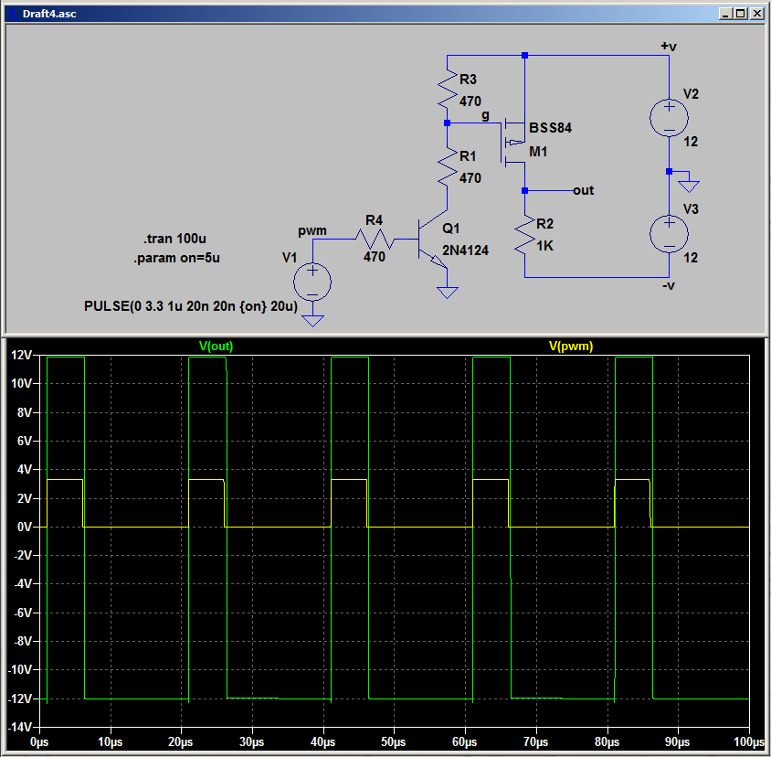

Here is another approach. It also distorts the PWM duty-cycle a bit, but at least it stops at +-12V, with good rise-fall times.
Oh fantastic Mike. I knew there'd be a way to do this using MOSFETs. This is exactly what I was looking for. There's 8 of these in the final application so I was aiming for the lowest part count whilst maintaining low-noise. Really appreciate yours and alecs help.

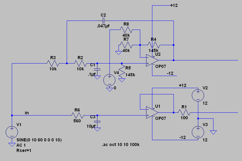

I started out doing what Mike did in #17. (active pull down)
Then I tried this.
V4 should be set to 3.3V for DC analysis.
For AC analysis it needs to be set to 0V.
R7 & R8 = 20k to 3.3V/2.
Gain is set by R4 & R5.

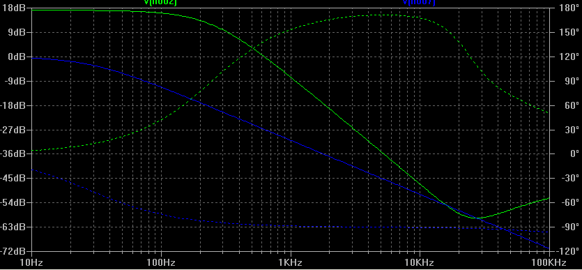

Remove U1. Just for fum.
Frequency response with 17db gain. and compare to sample RC filter. Keep the ratio of C1/C2. Change value to get the frequency you want.
Wrong OP-Amp. Just pick one at random. The +/- 12V could be +/- 15V unregulated. If you don't want to use R-R amp.
Hmm, i put this one into my sim and it seems to show periodic oscillation at anything other than %100 duty cycle
