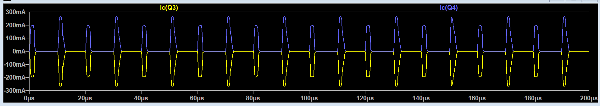

Here' a 3V to +-12V switcher which should give a pretty clean output at 50kHz :
Not very nice. There's considerable shoot-through :(.
Still alec_t that's exactly what I was looking for originally. Spot-on Thanks so much.

The shoot-through comes from two places.
The first two transistors were really slow at turn off. So I made them "grounded base" and keep them out of saturation.
The last two transistors need a "turn off" resistor.
I have not gone back and checked each resistor. This is just a first try. Shoot through 10 to 15 mA.
That's a big improvement, Ron.
