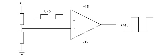

Update: I found a 5V to +/-15V DC-DC converter. I drew a quick schematic and attached it. Based on what all of you kind helpful folks have offered, this is my interpretation of what I should do. Can one or more of you please confirm that this concept looks correct?
Thanks in advance and sorry for being such an electronics neophyte :eek:

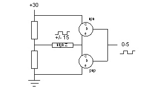

Or, would something as simple as this work (my apologies if this suggestion is ridiculous...:confused:...just trying to make something cheap and easy)

You need something more complicated than that if you want a push-pull output.
If you can get away with a pull-up resistor, you could use just one transistor.
I'll try to post something but I'm new to this computer and its drawing packages.

Go with the op amp solution...very simple...however you do realize (if we haven't explained) that you will need a bipolar power supply...one with a +15VDC/0/-15VDC output.
The a transistor circuit (very incomplete) gets more complicated than shown and gets into the problem of ground references between your input signal and your out load.

Thanks (again), Ken...I mentioned in one of my earlier posts that I found a 5V to +/- 15V DC-DC converter. Is there any reason that won't do the trick?
If its a NMA dc to dc converter, the answer is no.:)
:confused::confused::confused:
Ugghhhh....Yes, I am confused. Yes, I am an electronics neophyte.
Here is a summary of where I am at in this process:
1) I am trying to convert a 0-5V square wave to a +/- 15V square wave that will drive the inputs of a couple of opamps.
2) I have a single unipolar variable benchtop DC power supply to work with.
3) I am of the understanding that this circuit will do what I need.
drawing11_raster-jpg.34458
https://www.electro-tech-online.com/attachments/drawing11_raster-jpg.34458/
4) I am missing a way to give me the +/- 15V for the opamp V+ and V-.
Questions:
a) Is there a single IC (such as a DC-DC converter) or a simple circuit that I can use for the +/- 15V?
b) If so, could someone please give me some specifics?
c) If not, could someone please provide some specific alternatives?
Thanks.
