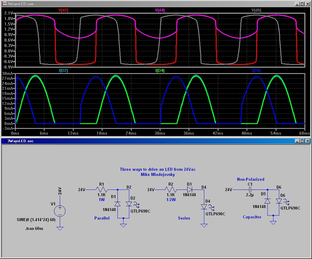

I thought about it some more, and here are three different ways to drive an LED from 24Vac:
The LED is already a diode, so no conversion is necessary, as long as reverse breakdown voltage isn't violated. Just use a suitable sereis resistor to limit the current to 22mA.
Due to their construction LED's have a 'low' reverse breakdown voltage, in the order of 5V, so with a 24Vac [33Vpk] a antiparallel diode is required.

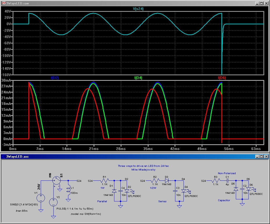

After thinking about it some more, I modified the three ways as shown below. The problem the additional component solve is to limit the current through the LED as the valve is switched on and off. By the time you add the series resistor to the Capacitor circuit, and considering that a non-polarized capacitor that big is hard to find and expensive, there is no advantage to it. I would use the middle circuit. The added 10nF capacitor protects the LED against the spike when the valve turns off.

Mike,
You said you would use the middle circuit... but you show 4 circuits. Which one would be the middle circuit???
Vinny
The left "circuit" is just the test stimulus for the other three in the simulation :D, so there are only three LED circuits. The middle one ("series") has the rectifier diode in-series with and pointing the same direction as the LED. That reduces the current (and the heat dissipation) in the current-limiting resistor. The reverse-voltage appears across the diode; not the LED.
The stuff to the left is the source of the 24Vac, the inductor simulates the coil of your sprinkler valve. The switch simulates the TRiac inside your sprinkler timer. The signal called S24 is what you will be connecting your LED indicator to...
