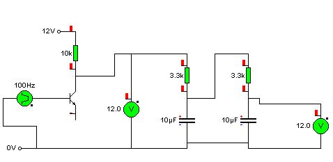

I tried this using crocodile clips simulation and it doesn't seem to work. Check if I'm doing something wrong. Btw, if i tie the emitter to 0V then it tells me the transistor will blow.
Image is attached..

Your emitter should go to 0V. I don't know why simulator thinks it will blow.
Power dissipation maybe? Do you know why it thinks it is a problem?
What transistor is it(part#?). I assume it could handle the 1.19 mA of current. Use a higher than 10k value to reduce power dissipation in device.
Also, what does the 12V have to drive? Is that the model of your load that you have shown? If you need the 12 to drive something, like I said earlier this might not be the right thing to do. But for light loads, this will reproduce your Waveform on 12V
You must insert resistor between PIC output and base of your transistor!!!
If you don't do that, Base-Emiter section of your transistor will short the PIC output to ground (well to 0.6V). This will be fatal to your PIC.
Ok, I got this working. However, from simulation again, this inverts the signal. If 5V is going in, I get, nothing out, then with zero in, I get 12 out. I solved this using two transistors, one after the other, but i'm not sure if this is the correct output.
