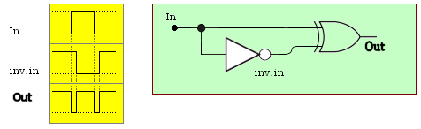

Here's one principle.
You need a XOR gate and a delay circuit. This delay circuit could consist of a RC and a Window Detector Circuit (WDC). The WDC kinda works like a schmitt-trigger but input levels can be adjusted to any needs.
It is however possible that you need an opposite of a WDC, but I haven't made any idea about this.
God luck :)

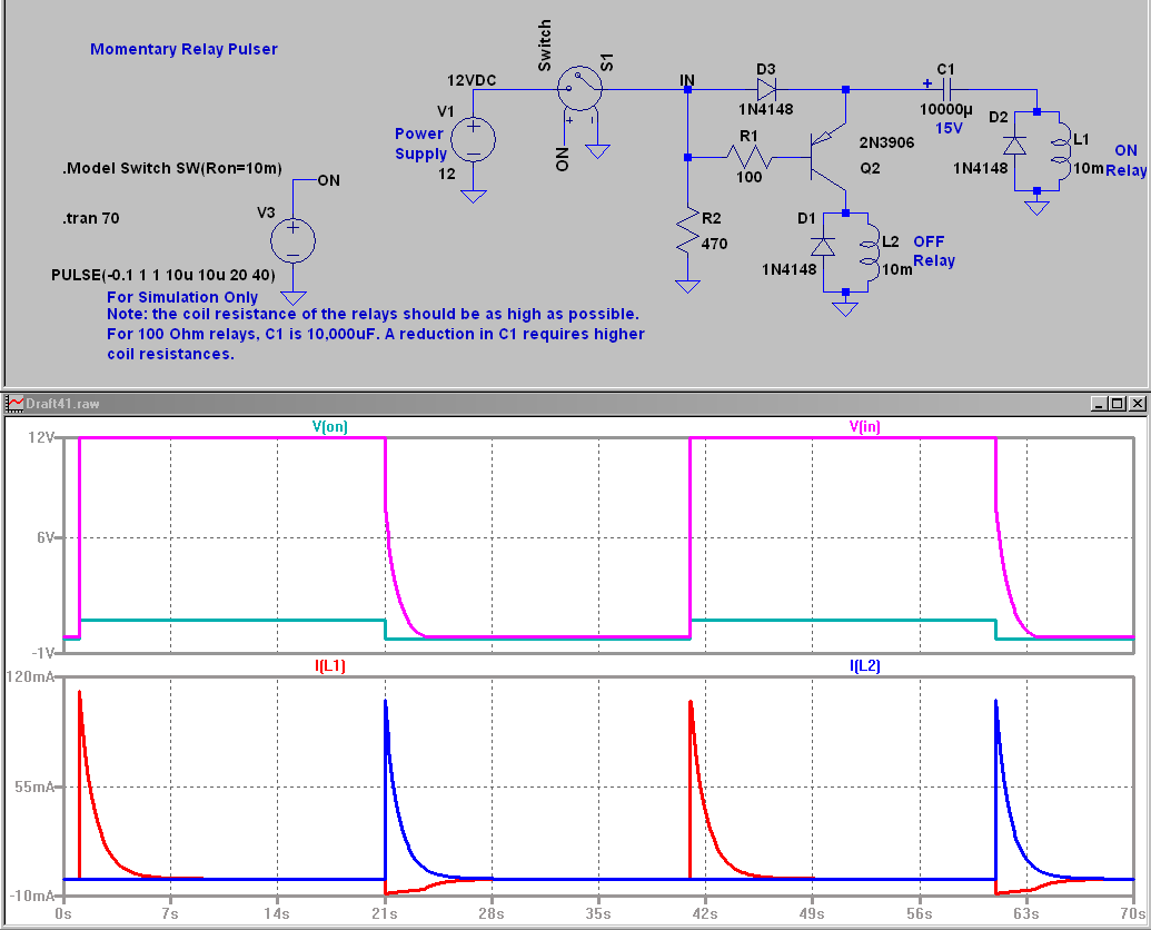

Here is a circuit that may work for you. It uses two 12Vdc relays with a coil resistance of >=100Ω.
The ON relay pulses for about ~1s when the SPST switch closes (rising edge of the 12V IN signal. The OFF relay pulses for ~1s when the switch opens (trailing edge of the IN signal). It is powered with a 12V DC supply that stays on (otherwise there would be no power to pulse the OFF relay).
You can wire the contacts of the two relays to the 24Vac in your system.

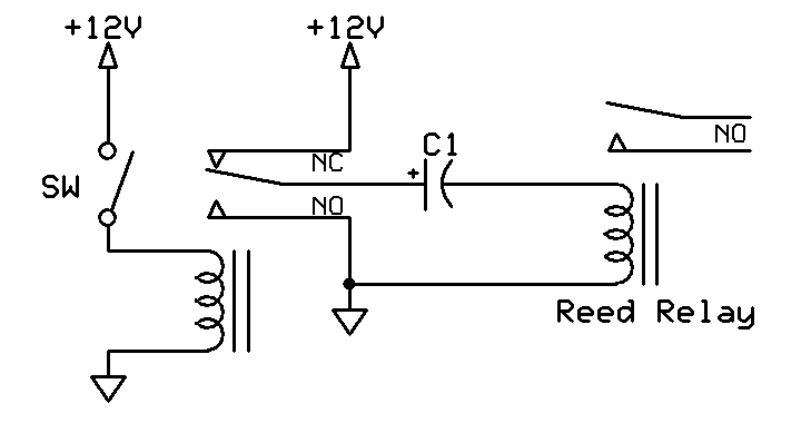

Or even a little more simple. ;) Opps! missed the need for a second relay out.

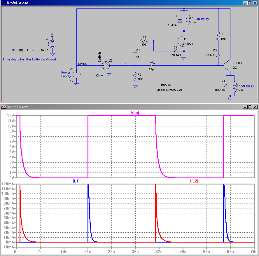

Here is a simplified version of the one I posted above. It doesn't require an unbroken connection to the 12V power supply. It stores the energy required to pulse the OFF relay in a larger capacitor, which also pulses the ON relay when Power is first applied.
C1 is big!, however, if you can find some sensitive 12V relays you could make it smaller. The sim was done with 100Ω relays, so if you could find some 400Ω ones, you could reduce C1 to ~2200uF. Note C1's polarity.
