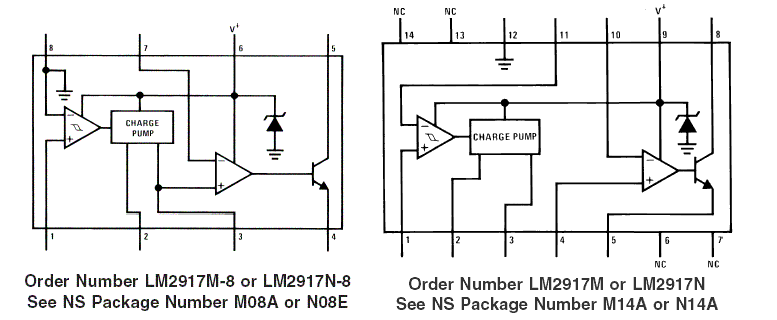

I agree with Nigel, no need any signal conditioner.The comparator input can accept almost any signal. Just pull-up the input with 10k resistor (hall output is an open-collector) it will work.
If You have a 14pin package, don't forget connect to GND the pin11. The pull-up resistor need between pin1 and positive supply, because the hall sensor output no give any signal without supply voltage (open collector).
i got it to work!
your method probably works too since but i went the other way...
i read up on some comparator stuff... i'm thinking it's teh same as your method too xP
I tried teh capacitors and had only the polarized ones so I tried it anyhow... it worked but then it stopped... i guess it couldn't handle it?
Anyhow... I was going to get a bigger cap but no need for that now...
I'll post the final schematic for a working tachometer once i get it done...
Thank you for everyone who has helped me in this...
all i can say now is...
:thumbsup:
thanx!!!
ps. well... umm... the +comparator was bigger than the -comparator. -comp was going straight to ground and the +comparator didn't exactly go to 0 since it has to deal with the sensor (has some sort of resistance right?)... solution... use a resistor and a diode and give the -comparator .7V which for sure is larger than the +comparatoer hence it can switch on and off :) wheeeeeeeeeeeeeeeeeeeeeeeeeeeeeeeeeeeeeeeeeeeeeeeeeeeeeeeeeeeeeeeeeeeeeeeeeeeeeeeeeeeeeeeeeeeeeeeeeeeeeeeeeeeeeeeeeeeeeeeeeeeeeeeeeeeeeeeeeeeeeeeeeeeeee
