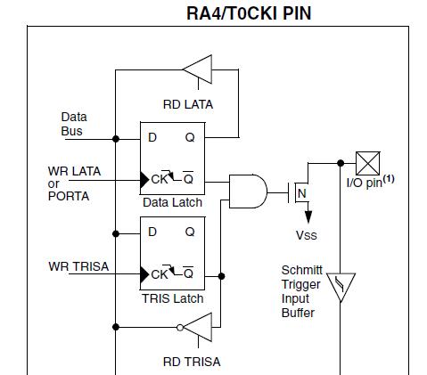

This one I/O pin has protection diode to VSS only.
RA4 would be a stupid pin to choose, as it's the only open-collector pin there is, and can be used to switch higher voltages than Vdd (hence you can't have a protection diode).

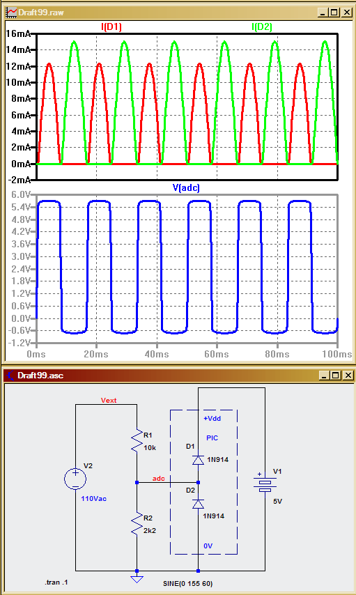

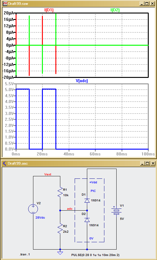

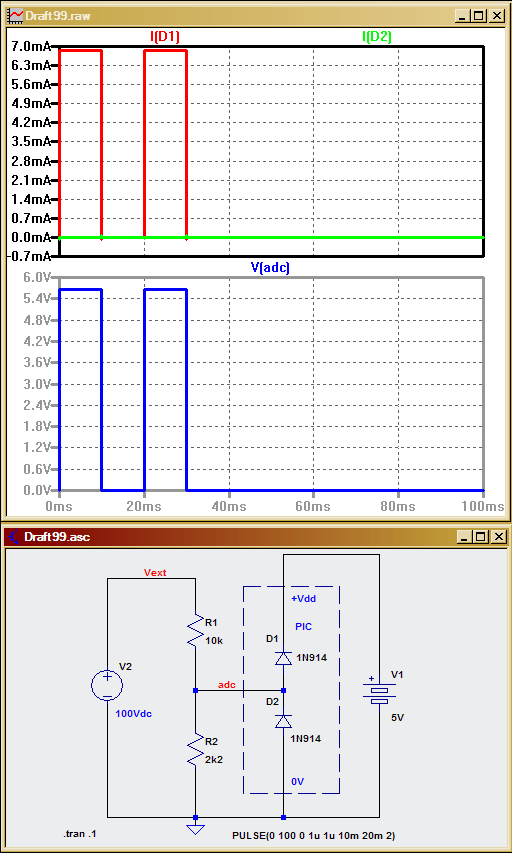

I know this is a well trodden path but this is the way I do it!.:)
The plots show the basic divider, for 28Vdc, 100Vdv and 100Vac.
With higher voltages, accidentally applied, the PIC's internal clamp diodes easily cope with the current.
I would not add a capacitor across the 2k2 unless the Vext source was 'noisy'.
IMO a zener diode is not required across the 2k2.
