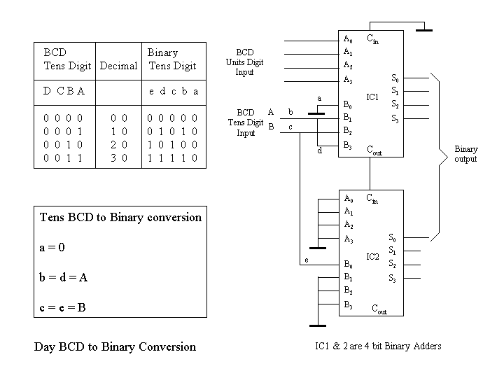

Another way to do it would be to use adder ICs. I posted the reverse circuit some days ago. See my response (dated Feb 15) to the post by "jupiter669" entitled "4-bit binary to decimal into dual 7 segment displays".
To convert from a 2 digit BCD to binary, you would have to multiply the Tens digit by 10 and then add the units digit.
There are several options. Here are some examples.
To multiply by ten you could either multiply by 5 and then by 2 or vice versa. Multiplication by 2 is easy, you simply shift the binary point one place. This can be done in the wiring.
To multiply by 5, you could either add the tens digit 5 times or add 5 N times where N is the tens digit. The units digit could be added first or last - which ever is simpler in hardware. But ensure that the units digit is NOT multipled by 2.

Here is an even simpler suggestion.
The diagram shows a proposal for the Day digits, the month digit conversion is a sub set of this one.
The year digit conversion is more complex since 10 tens digits must be converted.

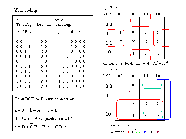

Thanks again for your circuit diagram for converting BCD to binary. I have simulated your suggestion and its seems to work fine. I have made a similar circuit for the Month digits. However I am having great problems working out how to convert the Year digits. It is 8 bits in BCD with a 7 bit O/P in binary. I think I may have missed the point. I have tried several times now to use the same layout as you, but I always end up with far more than 7 bits on my O/P! Please can you advise!? Thanks.
Here is part of the Year logic. It is more complex since there are 10 tens digits this time. You can use the same adder circuit, it simply has more inputs for the tens digits.
I'll leave you to do work out the logic for f and g. Let me know if you need help. Please check my binary arithmetic and Boolean algebra, I'm not immune to mistakes.
Len
