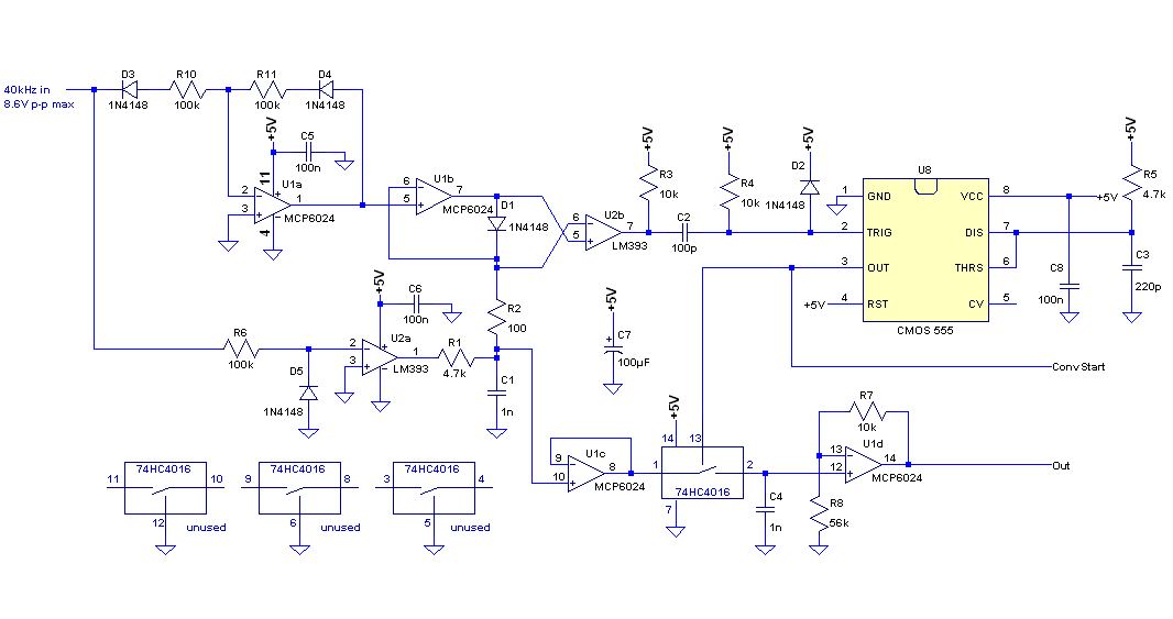

Ok, here's a circuit that uses a single +5V supply.
Why to get rid of the 555 of course, most PICs have comparator inputs that might work just as well. Timing done digitally too.
The PIC also has a sample & hold cap built in. No real need for the CD4016.
Lastly the PIC needs a low 2.5K input impedance to convert at full speed.
Is the PIC comparator as fast as the LM393 (which is no speed demon)? The discrete Microchip comparators I looked at were much too slow (4us).
Good question, I would think 4us was fine for this application, the comparators are connected to an interrupt and A/D coversion is a one shot deal. A/D conversion can be speeded up at the cost of accuracy.
I have almost zero experience with PICs. I have simulated the circuit I presented, and it works (in simulation). I can't simulate this function with a PIC incorporated, and I don't have the time or the resources to breadboard it. If you do, go for it.:D
Can you post an simulated image of the pin #2 signal?

OK, here it is.
