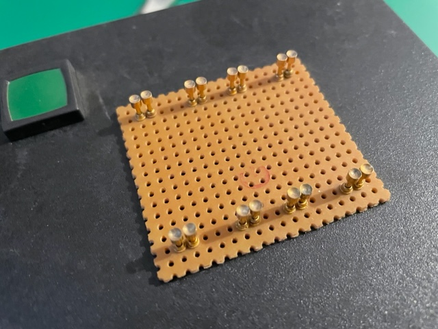

Are there any kind of plug/pin that could be (semi) permanently connected to the test points to simplify connecting to the SPI interface? As I am quite sure that if I decide to attempt this -- why not, the damn thing is dead if I do not -- then I will certainly need to connect multiple times.
"Pogo pins", if you can create a pattern on a bit of blank PCB or similar.
You can get various diameters & with either cup ends to fit PCB pins / leads, or pointed ends to connect to PCB pads.
These are some in a test rig for a control module we make:
Finger pressure on that one - it's a 24V unit so nothing dangerous, and the test only takes a few seconds.
On some other rigs, we have studs for the board mounting holes to fit over and plastic latches that hold the board down for the duration of the test sequence.
