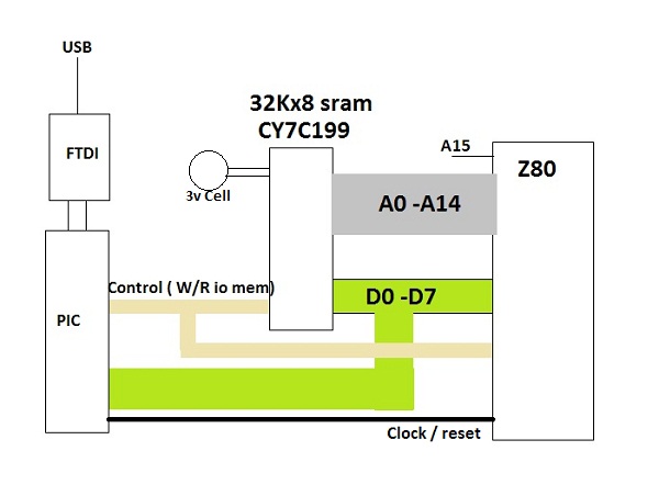

I had fun with Z80 in the past so I am quickly trying to see if a hybrid would work out Z84C00 . (10Mhz) PIC18F4520 and 32k x 8 SRAM on some vero (strip) board as i speak (type)... Not used PIC18 before only PIC 16 and 24 ,32 . (its too wet to garden here this week )

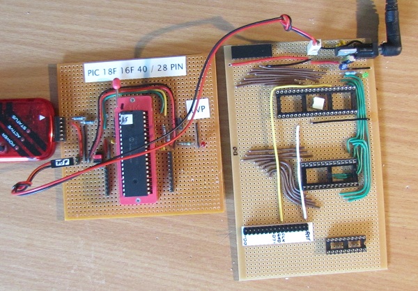

I am a couple of hours from my z80PIC hybrid test...:nailbiting:
Nice. I'm looking forward to seeing that. :)

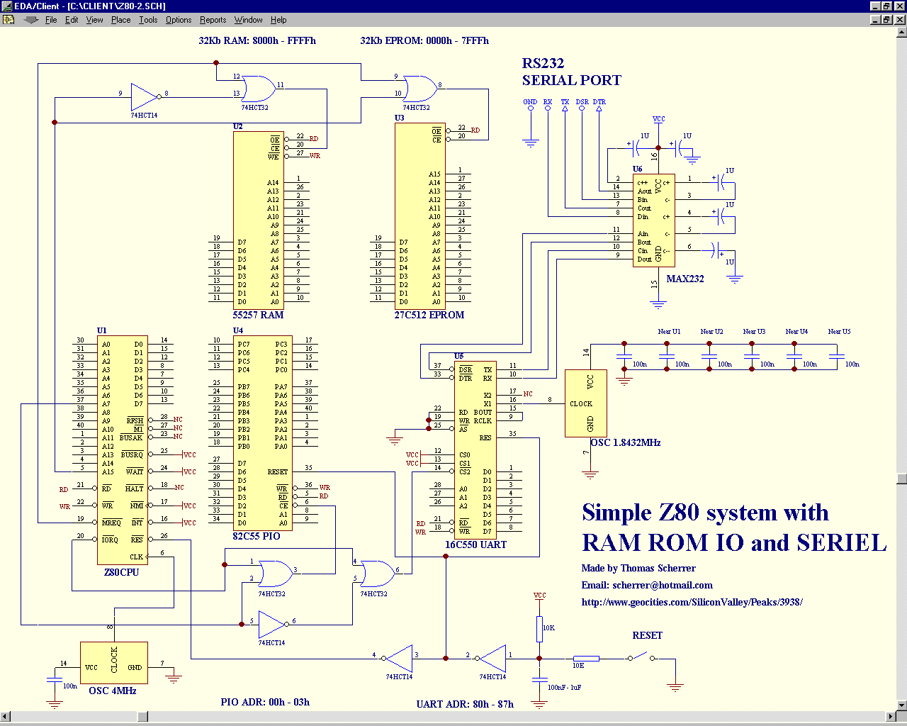

Nice, so you implemented one of Thomas Scherrer's more advanced (compared to my project) designs?
Not really, the Thomas Scherrer was a 'clean' reset example. after the reset it takes 3 full clocks to start running ,you would have to hold the reset > 3 seconds at 1Hz But if reset switch is noisy on release it will cause problems, check the data sheet. My hybrid is just to test the concept , a Z80 and SRAM with Clock , RD WR etc controlled by PIC , too soon to post a circuit, hope to start the pic code today.. from your observations the fetch instruction is not happening or Z80 not reading h'00 , can you see the M1 change state ? ( use slow clock ) I suggest you put a cap 1uF on the reset pin + [| - gnd with the resistor and switch, it might start as 'designed' on a power up.
