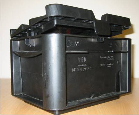

I found a very good offer for a larger ESD box for storing electronics - only 8$, but they hadn't got anymore, so I hope any of you know where to find a similar one (also for an affordable price). What are these boxes called?
ESD safe plastic boxes are over rated. If you need ESD protection use conductive foam and sink the leads of the chips into it, you can store them in pretty much anything, and so long as you run your hand against the surface of the box using a grounded wrist strap even the most static prone plastics can be used for electronics. I personally use ice cube trays for the little bits I rip off boards, never had anything go bad on me yet, no zaps either. My PC area does have a lot of grounding points though and the air is never damp.

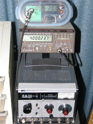

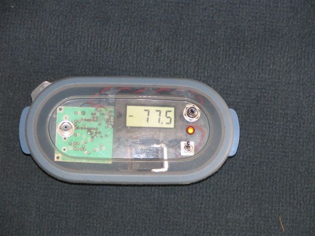

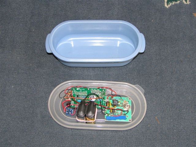

As someone in another thread suggested, I tried a 'tubberware' application last night. It's for a milliwatt LCD meter based on a Analog Devices AD8307 log detector chip. Neat 8 pin chip by the way that I'm getting over 85db of range from -75 to +15 DBmw!.
Anyway, I talked SHMBO into giving me one of her tubberware sealing containers. This one is about 8"X4"X2" and has a semi-translucent top. Pics below.
I mounted everything to the inside lid using a hand reamer tool to make quick holes for the switch, connectors, etc. You can't tell well from the picture but the LCD display is just glued (silicone RTV) to the inside of the cover, no cutout needed to see the display!
I found this to be a very quick and easy way to get a prototype mounted for safe handling. I see tubberware in thrift stores for pennys so this has got to be one of the most cost effective ways I can think of.
I'm sure I'll continue to explore and develop this tact of mounting.
Lefty

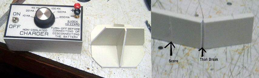

If you have any Plastic Suppliers in your area, go buy a 4 by 8 foot sheet of ABS Plastic.
It comes in Various Thickness and most common in Black or white color. (Sometimes in other colors)
.08 to .125 inch thickness is quite good for cases.
Its Fairly Expensive, But you can Make a LOT OF CASES from a Shhet of this.
You can cut it into any size or shape by Scoring it with a Razor knife (Exacto-knife) and break it.
(Somewhat Simular to how you cut Ceramic tile)
You can than Join the Pieces together using "MEK" (Methyl Ethyl Keytone)
Let Dry and than a bit of Filing or Sanding to Finish it off and you have a Custom Case to fit any Project.
Now you can make Custom Cases, Any Size or Shape that you Want. And Quite Cheaply.
To Finish a case fairly nicely, Draft up and Print off a Decal onto Clear Acetate. Than glue it onto the case using "3M Photo Mount Adhesive".

Here are some Simple Examples, also Score and Break:

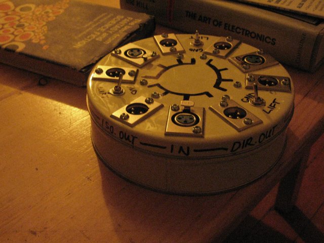

I've used cookie tins...
...for instance, for mic splitter boxes. Sand the rim under the lid and around the lip of the base to make a good contact. It's actually sturdier than I would have thought; I hung the hardware (including transformers) from the inside of the lid and the weight pulls the lid down into a nice concave shape which makes the thing way more rigid than it was before.
Now I just need to convince the missus that Jensen transformers are something worth springing for.
