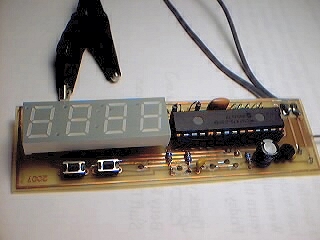

You are correct. I was my hope that the case was not unique to RS.
It is for another copy of the SuperProbe design by Mondo Tech. This is the current PCB 1.2 by 3.2 inches. It has the LED display and two switches so getting it into a case is a bit tricky. If all else fails I may add a ICSP connector and coat it with epoxy putty.

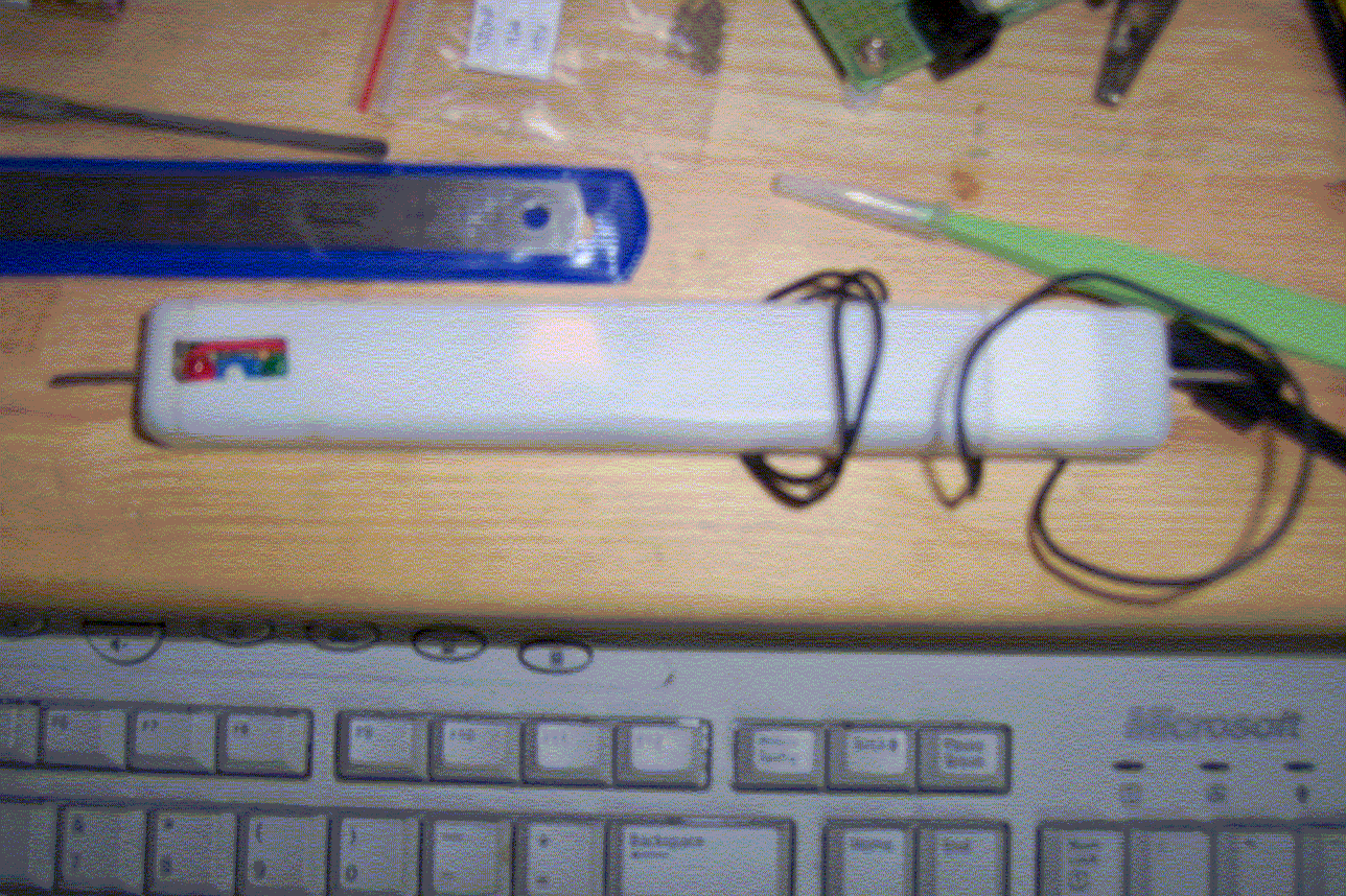

Here is a quick photo of my probe in a free toothbrush case. It is only 7/8 inch wide, but I think the one one can buy in the dollar store are a bit larger.
The hole for the LEDs was a quick hack because I needed to use the thing right away. If some time was taken, it could look much better.
The on switch can be used by pushing on the case.

Paper Mache ...........
3v0 said:
Does anyone know where to find a case similar to the one pictured below.
If you must have a close fit, make a case of Paper Mache, it should be easy enough. First wrap your project with a couple of layers of freezer paper, plastic side out, tape to hold together. Then apply Paper Mache in the normal manner until you have a stiff enough tube, slide off, trim ends, sand and paint. The end caps can be made of plumbers epoxy putty.
