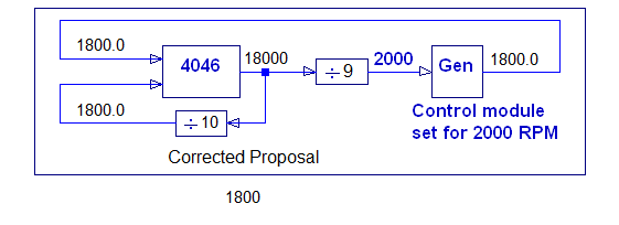

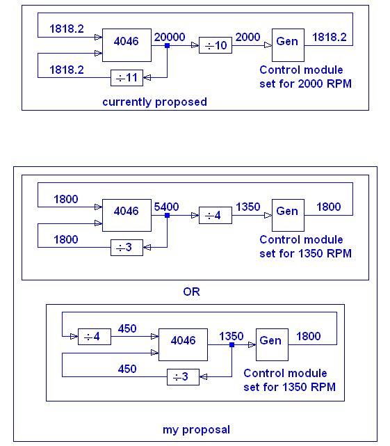

I may be wrong, but it seems to me that if you want the generator to put out 1800 RPM while the control module still sees 2000 RPM, you will need to multiply the frequency by 1.1111..., which is difficult to do
Multiplying by 1.1 will yield an output of 1818 RPM, which is close enough for appliances, but not for clocks. If your clocks running 1% fast is not a problem, then x1.1 should be fine. See the upper scheme in the attached diagram.
It might be better to set the control module to run at 1350 RPM, and use one of the lower schemes in the attached diagram.

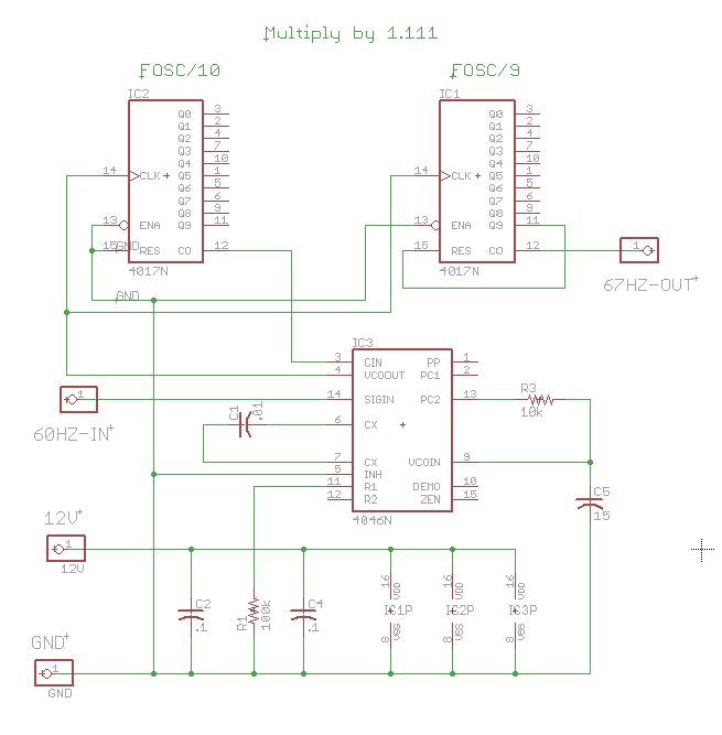

Actually not difficult at all, 1.1111... is 10/9. I guess I screwed up the arithmetic! :eek: Thanks for catching that. :rolleyes: So you set the VCO to a nominal 600Hz. Divide by 10 for the VCO comparator and divide by 9 for the governor.

Still, dividing by 3 and 4 might be simpler.

I was lazy Friday and didn't make a diagram for a 10/9 frequency multiplier. Tomorrow?
Thanks to all of you for your feedback. This module has three preset speeds.1350,2000 and 2400 RPM. Since I am new at this I just logically assumed it would be less complicated to work off the 2000 RPM setting since it is closer to the 1800 RPM I am after.I thought since all the box cares about is maintaining its preset speed chosen which is monitored by the Freq. (yellow wire). If while set at the 2000 RPM setting if I could convert this right before it enters the digital control to read 2200 RPM the module would do its job and drop off the 200 RPM placing me at the sought after 1800 RPM.
I think you are correct. What threw me off was the 2200 RPM that you mentioned. That would never appear, because the feedback loop would keep the input to the controller at 2000, and the output of the generator at 1800. I think you knew that.

Attached is a tested schematic of the 10/9 (1.1111...) multiplier. I/O may require buffering, depending on the signals to be interfaced.

Was wondering if you divided by 10/9 working off the 2000 or 3/4 working off the 1350 RPM setting what is this difference? Would one over the other be more accurate,take less components? I don't know and am just asking why one is better or why one would be worst? On my generator when RPM is manually set(not governed) at 1800 RPM putting out 220V at 60 Hz all is fine. However when a big load is placed on it like my 1-1/2 HP 220V well pump which is 320 Feet deep it draws 14 amps just to start and about 7 amps to run. With no governor generator slows down, the house lights dim (bad) because the engine is not governed at 1800 RPM.If I quickly manually adjust it back to 1800 at 60 Hz all is fine until the (load) well pump kicks off and then I it now revs over 1800 and over 60 Hz (bad). Also am I wrong in the way I am approaching this problem? I need someone to clarify my thinking that this control box has programming already with three speed sets. I need 1800 with maybe an adjustable pot for variation. So on the computation of the divide by 10/9 should not the answer be 2000 converted to 2200 RPM then when the control software sees this it will compare and drop off 200 RPM thus placing me at 1800 RPM.Or the divide by 3/4 based working up from the 1350 RPM setting. Should it not deduct 450 RPM placing RPM now at 950 as seen by the control.Then the control would add 450 RPM putting the governor at 1800? What am I missing? I am learning several things here and appreciate all input since I am inexperienced at these thinking processes. Thanks
