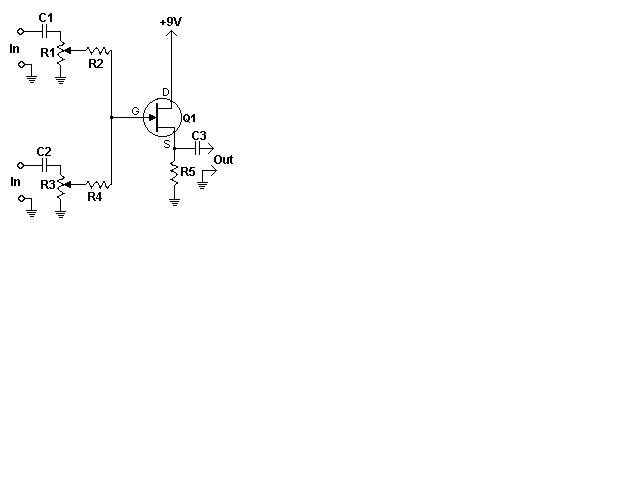

Hi all, im looking at making this circuit for a audio mixer.
I would like to try and understand how it works before i attempt to build it :)
The main thing im unsure of is the FET's purpose and why do you need a 9v supply?
thanks
Well that's a REALLY poor mixer, barely worthy of the name. Far better to build a proper mixer using a single opamp.
The FET (or opamp) is to provide gain to make up for the losses in the mixing process, the 9V battery powers it.
I think the choice of using FET is just a random choice. An opamp amplifier or a common emitter should work as well.
The fet here is used like an emitter follower. It has no voltage gain, but it supplies a high impedance point for the signals to be mixed together and increases the current so the signals can be sent to another stage. You need a voltage supply because transistors don't work without any voltage or power, and it's 9 volts so several volts of signal can be handled without clipping the peaks off.
