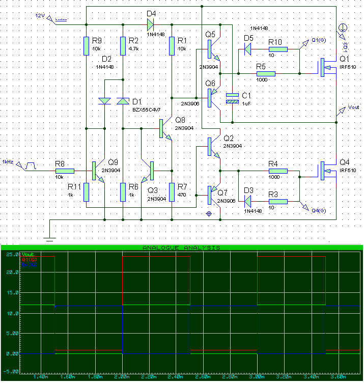

Here is drive circuit using both N devices per leg where the supply for the upper device is established by a bootstrap arrangement. It is a bit more complicated.
Simulation results indicate a working circuit, however one should carefully monitor the two gate signals in practice for any overlap (with some current limit like a 12v bulb placed in series with the drain of Q1) and make adjustments (gate resistance/capacitance) to the calculated values, for the type of device used.

I do not see what purpose D5-R10-R5 and D3-R4-R3 serve. Why are they here?
You have used an NMOS for the pullup driver. This is a problem since the gate voltage needs to be higher than the output, but there is no voltage above the 12v rail to drive it so the output is very limited and prone to distortion. A PMOS is the proper choice. The gate signal will need to be inverted.
Faster off than on-time's
Yes there is ~12V (12-0.7V)

But you can't use an N here! The highest voltage that can hit that gate is 11V. The threshold for an IRF510 is 2-4v, so for the weakest of output current you will only be able to drive 7v to the output. For more realistic output currents, you're talking 4v to 5v output. This will probably overheat the MOSFET outright.
In general, N channels have lower on-state resistance and lower gate capacitance. But they make plenty of P-channel devices with better stats than an IRF510.
Lowering the switching times is often disasterous, but it depends on your switching freq. Each slow transition, on or off, creates a crapload of heat which can be many times greater than that generated by rds-on heating.
Just what are you trying to do? Is this a motor controller, audio amp, or what? Is it supposed to be half of an H-bridge? Is it driven by a PIC? How much current is it supposed to drive?
I do not yet understand why there is a pulldown transistor. Is this supposed to drive a transformer or something? A PWM used to drive a motor, etc would not need to pull the output low when the high side transistor is off.
That's the whole point of him posting the circuit, C1 is a bootstrap capacitor and provides a higher drive voltage for the top transistor, it's an extremely common technique!.
Boot-strapping is fine, Does mean a slightly more complex driving arrangement
ie for a leg you now have to send the complement to the N-types.
with a P-type and a N-Type in a leg you just had to send the signal
When you start getting to higher voltages (where using a P-type is way out of the question). Floating gate drives for the upper channels are needed := opto's for the signal and some form of isolated DC:DC converters for the power.
