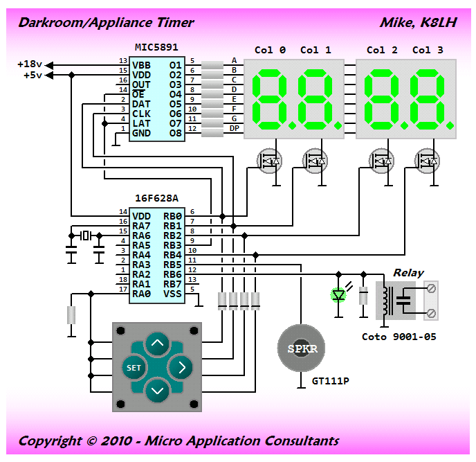

Hi cne,
If you ever want to consider a new design in the future to support those higher voltage multi-LED segments I think I would recommend doing it something like this;
darkroom-timer-png.39139
The 8-bit serial-to-parallel MIC5891 "sourcing" driver IC can use a source voltage of up to 35 volts on the VBB input pin. You would need to configure the segments as common cathode with this design.
Regards, Mike
