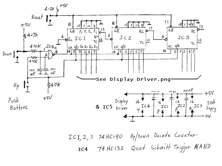

There may be some variations from what I posted before. I thought I made that point in an earlier post or PM. So give me a day or 2 to finalise. (I'm busy with other work)
OK, Len, we have gone thru so many possibilities in the last few posts that I think it is necessary to restate what we are working with. I currently have a circuit built exactly to the specs stated in the attachment from your post on 20th September 2007, 10:58 PM.
IC Components are:
74HC132 Quad Schmidt Trigger NAND (1) (For the debounce)
74HC190 up/down decade counter (3)
SN7447AN Display Driver (3)
If I could draw a schematic to save my life, I would attach a new one.
Len, take your time, I am going no where until I can put in another order. I will spend the time trying to figure out a PCB for this thing.
Sean

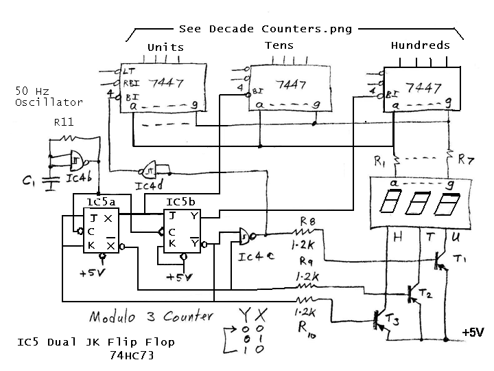

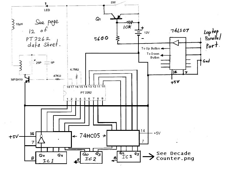

Sean,
I have made some small changes & improvements to the circuits and added a power supply. See attachments.
I have left Eric's computer interface. You can delete it if you wish.
You'll also need
2 x 74HC05 Hex o/c inverting buffers
1 x 74HC73 Dual JK Flip Flop
Let me know if you can't obtain either of these and I suggest an alternative.
I'll calculate the component (eg. resistor) values tomorrow.

Len,
I wasn't expecting you to reply for a couple days. It looks like you put a lot of thought into this.
I see that you updated the counter schematic to feed into a circuit that is intended for the original display that I had. I am no longer using this display because having the 21 resistors seemed simpler than the modulo thing. We covered this once a while ago.

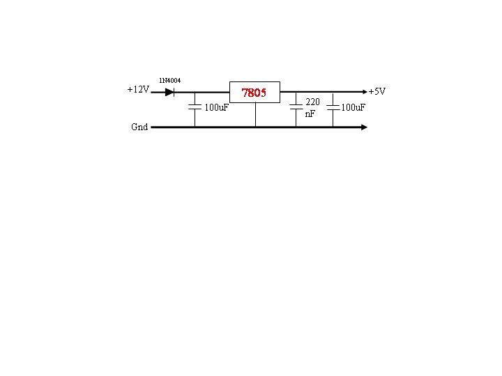

Is the power supply you drew up more efficient than the power regulator that I am using now, just the TA7805S? I assume the caps are to clean it up.
I figured I would use a 9v battery to power the counter, I might even think of using a small 6v cell like the 12v cell that is in the Tx now. This would be separate from the 12v running the Tx. Will this still work with your PS design?

I needed some breaks from the work I've been doing. Besides most of the design was finished, just needed a spruce up.
I see that you updated the counter schematic to feed into a circuit that is intended for the original display that I had. I am no longer using this display because having the 21 resistors seemed simpler than the modulo thing. We covered this once a while ago. I had forgotten that. Now I understand your PMs.
I don't know what the TA78055 is. if it is working, then leave it alone.

Sean,
You could simply use a 6 Volt battery with 2 diodes (1N4004 or similar) in series to reduce the voltage to about 5 Volt.
The Tx can operate with a 12 Volt supply while the rest operates from 5V. I think this may what you are asking about re the "PS".
BUT, be sure to connect the ground lines together.

So I can have two batteries but I need to make sure that the grounds are tied together. I think I can handle that.
I am not set on the 6v cell, I would have to figure out how long the circuit would run on the meager Ah those things have. I like the idea of not needing to include the voltage regulator that I am currently using, that is what the TA7805S is. Your circuit for a power supply included a 7805, I assumed they were the same thing. Yes Was I right about the capacitors? Are they there as stiffening caps like in the counter circuit?
The 220 nF is required for stabilty of the 7805. The 100 uF in parallel with it is to store charge for current peaks. You don't need the 100 uF on the left for a battery powered unit. I posted a copy of a PS I designed for a mains supplied PIC programmer.

A CMOS display driver would take much less from the battery than the 7447.
Unfortunately, most are designed to drive Common Cathode displays, but there is one that can be configured to drive either Common Anode or Common Cathode but I can't find it's number. So if you want to minimise your battery comsumption, I suggest you start a thread asking about CMOS display drivers that can drive CA displays. Or, alternatively, buy 3 CC displays and a driver such as the 4511.
I have decided to use the 74HC05 Hex o/c inverter to interface to the Tx. It is CMOS and low power consumption and inverts the signals. The 74LS07 does not invert and consumes more energy.
I want to invert the signals so that a High from the counters applies a Low to the Tx. And a Low from the counters applies a "F" to the Tx.
This will make it easy in the Rx as the thumb wheel switches can be configured to switch gnd to the C pins.
