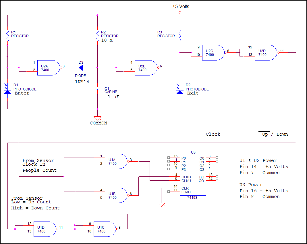

hi there can somebody give a counter circuit that can be use in a coin bank that can be joined by a 4 digit 7 segment display ?? i'm only using a single type of coin and my goals are to count the total value and display it to the seven segment display .. really need support here ..

Yes, it can be done. Not 100% on the design but it can be done. There were threads sometime back (maybe 6 to 12 months) where there was focus on a people counter. Someone enters the room (place a coin in) and the counter increments up. Someone exits (a coin is removed) and the counter decrements down. I think I have some rough circuits of the design at home (at work now). I'll see what I have and post. You may want to Google People Counter and use the forum search for people counter. People coins? All counts. :)
Then the matter of counting by coin denomination has to be dealt with.
Ron
You could use four 40110 decade up/down counters which directly drive a 7-segment display. It has separate up and down clock inputs. Of course it only increments/decrements one count per clock pulse, so if you want more counts per coin you could add an additional binary counter and a 555 astable circuit as a clock generator to generate the desired number of clock pulses per coin.
Attached is a basic design of the people counter I mentioned. For now forget about the actual counter. Focus on the two LDRs and how they drive the logic gates. When all is said and done we determine if something (coins or people) is going in or out. This gets into giving a counter an increment up or decrement down pulse. The pulse is determined by which LDR has a beam of light broken first, In or Out. The circuit is an example of one method for determining if coins are going in or out.
The counter Carl mentions is a programmable Up/Dn counter much like the one shown n the attached. From there you would do as Carl mentions.

Attached is a basic design of the people counter I mentioned. For now forget about the actual counter. Focus on the two LDRs and how they drive the logic gates. When all is said and done we determine if something (coins or people) is going in or out. This gets into giving a counter an increment up or decrement down pulse. The pulse is determined by which LDR has a beam of light broken first, In or Out. The circuit is an example of one method for determining if coins are going in or out.....
Such complex logic is only needed if the in and out port is the same opening. If they are different openings, then the sensors can directly trigger the respective up or down clocks.
Ah yes, good point Carl. I think I had visions of the piggy bank when I was a kid. The coins had one way in and only one way out (short of a hammer). :)
