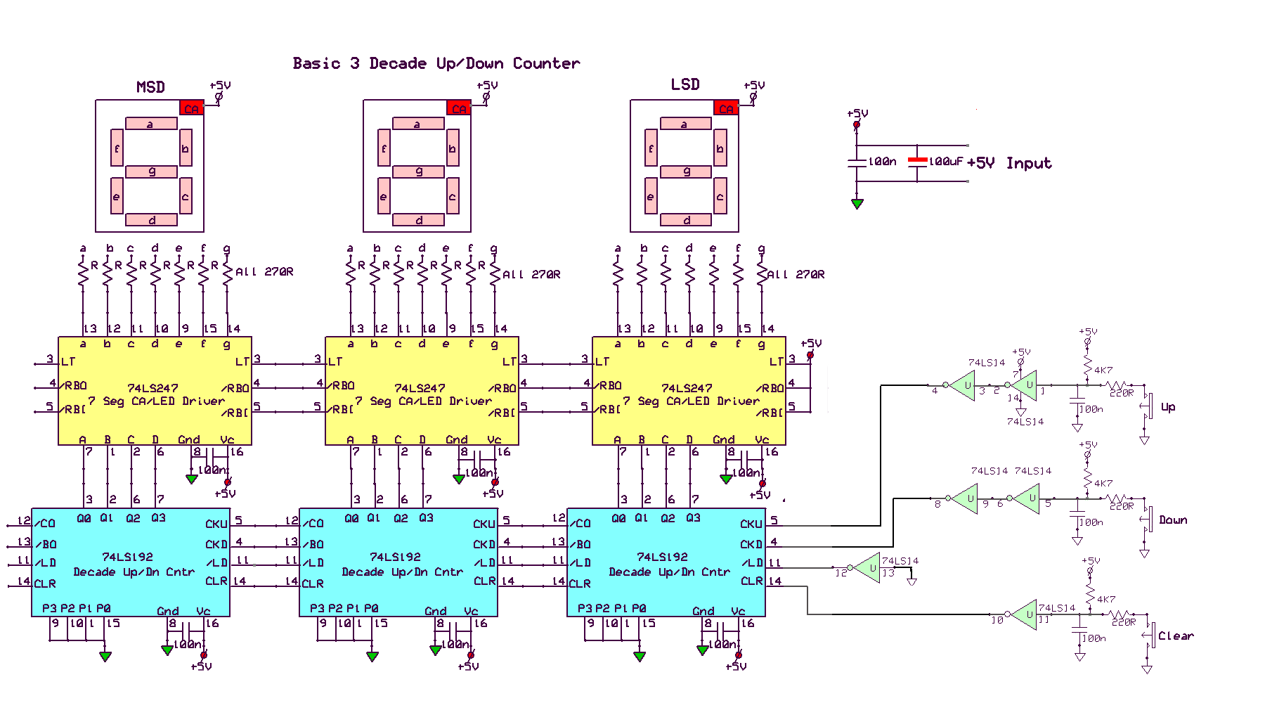

yeah! can you give me mate ..BCD and output will drive to the display .. my display is 3 digit seven segment display.. do you have circuits for that ??

eric in the circuit you gave to me can i use sensor to know if it's up or down ? where should i put it ? i'm using a 3 seven segment display ..thanks!
Which one of those circuits are you considering.?
I have combined the 3 decade counter with the manual input switches on this circuit.
When you say U/D sensor, do you mean an LED.? if not what type of sensor.?

i'm going to use LDR or Photodiodes mate .. .
To use LDR's or PD's for detection you require a comparator circuit, say a dual LM393, that will produce an Up or Down pulse when the light path from a light source is blocked. The comparators would replace the push switches and the inverter IC on the clock pins.
We would need to know the resistance of the LDR when illuminated and when dark.????
reload gave me a circuit of people counter .. can you look to it the previous page of this conversation .. yah i'm going to replace push switches with sensor .. one sensor for enter and one sensor in exit ..
