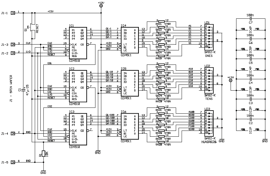

i checked with the datasheet, its not necessarily to be changed when the clock is high. see the timing diagram on the data sheet. but it can be allowed to change when the clock is high and will only reflect during the next clock.
I think the concern with changing the UP/DN pin when the clock input is low has mostly to do with possible counting errors introduced from the delay in the UP/DN input not being sensed until the next clock cycle. I know it is not in the data sheet. I got that info from here. The source could be wrong but if you scroll down to where they talk about ripple counters, it's mentioned. I haven't done an exhaustive search of the internet to see where else this concern is mentioned if anywhere.
One other thing. I guess I wasn't paying close enough attention before but your schematic has seperate outputs for count up and count down. I haven't simulated your circuit but I'm assuming count up is high and count down is low when increasing the count, and vice versa for decreasing the count. The 4510 only has one pin for both up and down. If the pin is high, it counts up. If the pin is low it counts down. So either he'll need to choose a different IC that has two seperate pins or have to add an additional logic gate or maybe a few transistors to make your output compatible with the 4510.

OK, I see in post#8 how you have combined the two outputs into one with the 2 NAND gates. That is what I was referring to so sorry that I didn't notice that you had already thought about it.
As far as whether or not you should change the UP/DN pin state at times other than when the clock input is high, here is an expert from the datasheet you linked to in your last post:
Ripple clocking mode: the UP/DN control can be changed at any count. The only
restriction on changing the UP/DN control is that the clock input to the first counting
stage must be “HIGH”.
It's on page 11, figure 13, in the note at the bottom of the figure.
yes it has been mentioned in ripple clocking, any how its depend on the coice of the OP whcih type his selection gona be.
if he will have any problem that time we can sugest some alternation.

I guess false clocking (counting) cannot occur since the direction information is there before the clock pulse.

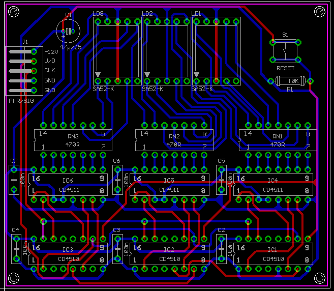

I made a circuit counting three digits using CD4510 and 4511. If you need a lower count just omit one or two counter(s) and decoder(s)/driver(s). PCB size is 3.3X2.9inches (double sided).
Simulation shows that even at a relatively high clock frequency (10Hz) the counter reacts immedeately when changing count direction.
I'm more afraid that kids learn pretty fast how to "cheat" the counter. For that reason I have included a RESET button to correct for false counts.
