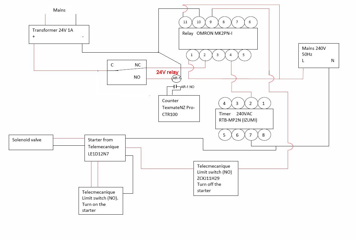

I am designing a control circuit for a process procedure. Everything to date works fine and according to specifications.
The only problem I am facing at the moment is the issue of my counter (which is a pre-purchased from TexmateNZ in New Zealand) is skipping in counting every time a Limit switch is closed. The funny part is that the counter leads are not even connected to the Limit switch (NO/NC connections).
I am feeding a Telemecanique Limit switch with 230V AC 50HZ supply and wanting it to NOT count once it's closed or opened. The counting should be done through another switch which is in this case a pressure switch. When the pressure switch (Sensor) closes (Normally opened) then the counter counts 1 cycle PERFECT!!!. But when the limit switch #2 closes the counter skips in counting (problematic area)
I thank you in advance for taking a look at what I have to say. Any ideas or suggestions would be much appreciated.
Can you post a schematic of how you have it hooked up. The URLs of the components would help, too.
Thank you Mike for replying.
Okay so I have attached a drawing I did of how I have the test circuit connected. I hope it helps clarify a few things.
Let me try and explain a bit more in detail what I am trying to achieve with the design below.
I was instructed to control the pressure in a cylinder being tested for a pulsating test. At the moment the test rig consists of a electrical AC motor 412V with its own starter which runs a oil pump. The oil pumps pumps oil from the oil tank to a Low pressure cylinder and a high pressure cylinder. The pressure is then sent to a Test cylinder. Once the pressure in the cylinder reaches its desired value a pressure switch (sensor) then changes states and should turn the polarity of the solenoids that pass the oil to the pistons to reverse the direction of the oil back to the oil tank. I am using 2 solenoids that are of interest to me.
Verything WORKS a treat. The only problem is that When I connect the counter to the pressure sensor or the relay contact, so that the contact of the counter close and it reads a cycle (1 count per cycle) it starts skipping in counting when the limit switches are pressed. The counter leads as I drawed below are connected to the Pressure sensor and not the limit switches. I suspect this could be a bouncing issue in affect here but I don't know how to solve this particular issue.

what i understand is some interference during other limit switch operation, or may be due to contactor operation connected to that. you can use a filter at the input. all depends on your counter.
This sounds like noise getting on to the power supply connection of your counter. Are there long leads somewhere that could be picking up the noise? Can you get to the power supply connections of your counter? A 100uF capacitor across the leads close to the equipment should help reduce the noise. If not, try transient suppressors across your contacts, or putting a metal screen between your contactors and your counter.

i see on the circuit you posted, you have connected the pressure switch to the counter input mean time its giving a path to relay too, try to make an auxiliary contact using a 24V relay so that the input of the counter is isolated from 24V supply terminal.(see the attached) i doubt the noise is from this way of connecting it.
Also about the capacitor, its not to the power supply, you have to connect it across the counter inputs(NO) as a filter, and with a parallel resistor.

Your relay coil is pins 2 & 10 for 24 VDC. Your problem is likely caused by as mentioned noise. You may want to think about placing a diode across your relay coil. Like a 1N4002 to snub the inductive kick when that relay coil opens.
Relay pin 10 Anode and Pin 2 Cathode of the diode.
As to the relay contacts you can snub with a 47 Ohm 1/2 watt resistor in series with a .1 uF cap. Note the cap and resistor are in series. This read should explain the snubber. I would start with the diode across the relay as I mentioned earlier.

I just tried the design that you suggested using the Auxiliary relay contact. Unfortunately the counter is still incrementing at random every time the limit switches are pressed.
I was wondering is there way in calculating the capacitor filter size?

Have you tried clamping the relay coil as I suggested or read the link on how to use a snubbing RC network on relay contacts? If you have a scope at your disposal you may want to look at that relay coil when it opens or across those contacts.

Hi Ron,
Well, what can I say!!!
The snubber method didn't work, the Diode clamping method didn't work. Nothing I tried rectified the problem. I can say however it reduces the number of times the counter is actually incrementing randomly, and the number of random increments itself. Example: without the clamping method on the relay coil and the snubber RC circuit, I was getting a random increments every 2nd switch on of the Limit/switch with increments of 5/12/30 random numbers (Just purely random sequence). Now that I tried connected the Clamping and RC circuits on the relay in question as you and Mbarazeen suggested, it started incrementing the counter every 5/6 limit/switch on at a increment value of 1 each time (slight improvement, but still no cigar).
I have given up using the Limit/switches and have taken a different approach using magnetic switches. With those it seems to be working after an hour of On/Off action using a magnet (Tiring).

Your limit switch is clearly causing switch bounce. You need to debounce the switch. Read about switch bounce here
The Ganssle Group
You may be able to get away with using the RC switch debounce without the inverter IC. Give it a try, I am sure your system has too much bounce in it's step :)
In a nut shell, the limit switch is mechanical and produces erratic operation when it is activated causing random pulses to your counter. It takes a certain period of time for the switch to become stable.
The limit switch kinda puts a waveform out like _||||_||__|~~~~ Red portion is stable, not the best picture but hope ya get the idea.
