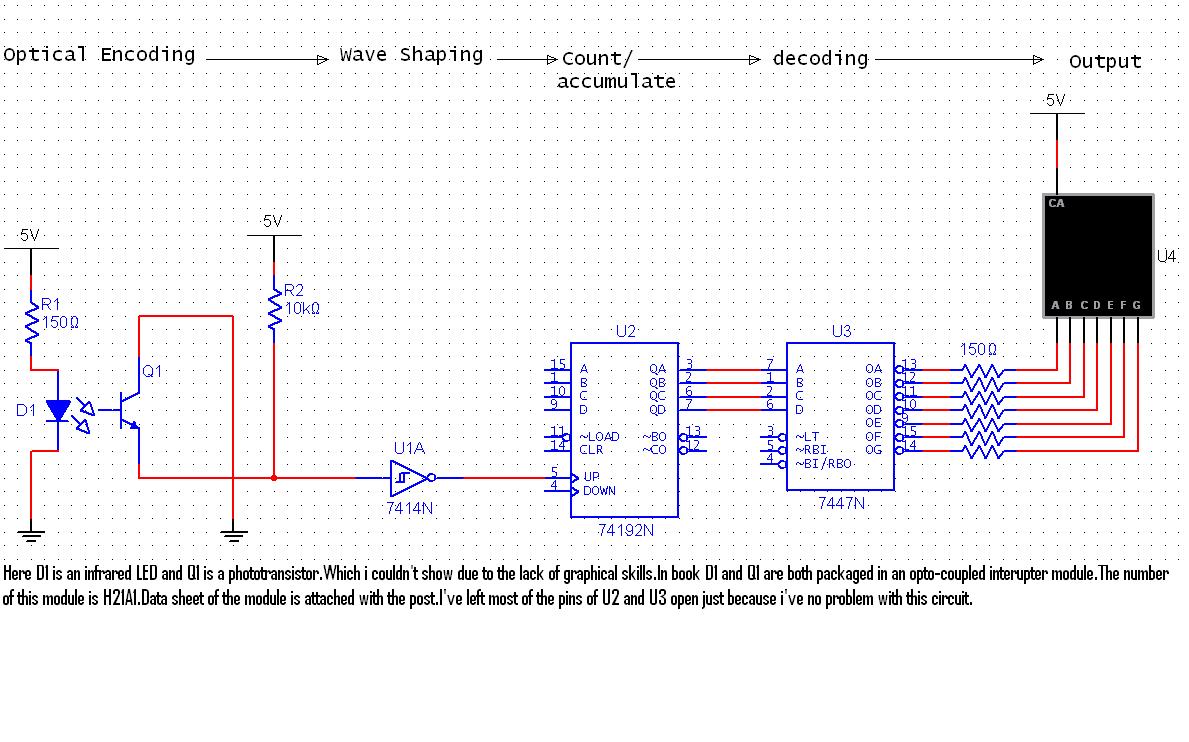

I am currently working on this project.Circuit diagram is attached in JPG format and pdf is data sheet as described in the diagram.
This circuit uses an IR LED with a phototransistor.When a cog wheel(or just like it) between D1 and Q1 rotates IR is inturrpted each time a slot passes between them.My problem is that i Want to use separate Photo-transistor and Separate IR LED instead of H21A1 (as described in the figure).Here Maroon coloured boundry box covers H21A1.
Now if i want to use D1 and Q1 seprately,
What kind of IR LED and Photo-transistor can i use here.
Plz check the circuits.
Thanx in advace for ur ideas and comments.

I've soldered the 74LS14, 74LS192, 74LS47 and the 7 segment LED.Now the UP/Down counter is working fine when i give 1 Hz clock signal to the 74LS192.But as mentioned in circuit diagram, when i connect the output of schmitt trigger to the UP terminal of 74LS192 and the input of that schmitt trigger to a push button PBNO and the other terminal of this PBNO to 5V( or even with ground) i don't get the desired reading when i press the PBNO (i.e 1 should be added to the previous state when i press the PBNO once, means if LED is showning 4, after pressing the PBNO once, it should be 5).Mostly i m giving 5V from a USB lead.But i've tried it with Digital Power supply too.Now what is the problem.
What exact voltage and current should i give to the PBNO connected with input of shmitt trigger so that when i press it i get desired reading.This is necessary for me so that when i add the optical transistor and IR LED to the circuit, i know the exact voltage and current that this pair should provide when a slit is present and is not present between the pair.
I've replaced many 74LS14 but still in vain.
Please help me.It's urgent.

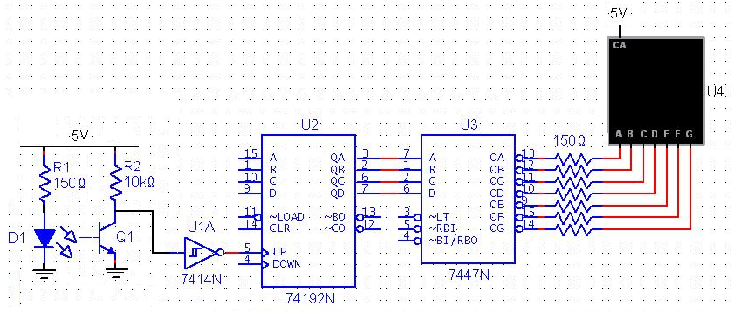

Why is your schematic spread out all over the place?
Why does your schematic have dots all over it?
The photo-transistor had its emitter and collector connected backwards.
I think it should be wired like this:

The answer of your first two questions is that i made this diagram on multisim from electronics workbench and i didn't import that circuit cuz it missed a lot of details, so i took the screenshot.
while for your last comment i did that cuz it was same in the book from where i picked the circuit, but i'll try to do that way too.But my main problem is that if i don't connect the transistor and try to make the circuit work with a PBNO it should do in my opinion but it does not.

Audioguru is right. The phototransistor is connected wrongly in your circuit. His circuit is correct.
Quote
"But my main problem is that if i don't connect the transistor and try to make the circuit work with a PBNO it should do in my opinion but it does not.
I wanna know of this problem"
Your problem is due to contact bounce.
Push buttons and other types of mechamical switches do not open and close cleanly. When you press the button, the contcts close and open several times before finally closing. And the same occurs when you release the button, it opens and closes several times before finally going open.
If this is driving a counter, then the counter counts every pulse.
So you need a bounce suppressor.
This issue has been raised in this forum several times, so I suggest you do a search for "bounce suppressor".

I too thought about the contact bounce but the counter doesn't change any state.It should show any transitions even if the contact bounce is present as is the case.
Are you certain that +5V and GND are properly connected to the 7414? Do you have the 10k pullup resistor connected to the PBNO and the 7414, and to +5V? The circuit should work if it is properly wired.

The circuit would probably work without the 10k pullup resistor from the input of the 7414 to +5V, if you are using TTL, although the pullup is still advisable. If you are using a CMOS 7414, the pullup resistor is mandatory. The circuit won't work without it.
The CLR input of the 74192 is active high. Your circuit shaow that it is open.
With TTL open is equivalent to a high, therefore the counter is being permanently reset. Connect the CLR to gnd.

If you look at his schematic, he says he left the pins open because he doesn't have a problem with this part of the circuit. I am assuming he means that he actually has them attached to the appropriate rails on his hardware, but didn't want to bother drawing them on the schematic.
