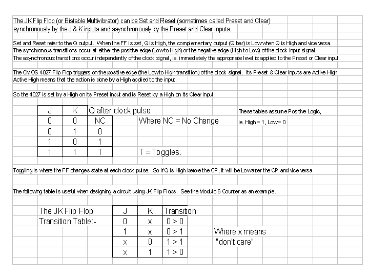

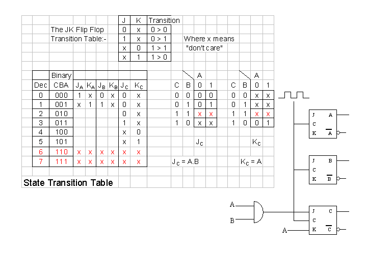

i want to make 3 bit up/down counter using j-k flip flops ( sequence(0,2,3,5,7)).can anyone help me to do this

All you need to know is right here:
Here are 2 attachment I did some time ago for someone else. He wanted to design a counter using JK flip flops. This shows the procedure for designing counters using JK flip flops.
Len
