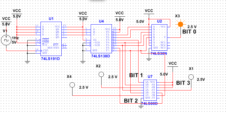

Okay.
Well you are going to have to explain what that schematic is because that bares no resemblance to the schematic i suggested. What i suggested was a neat and orderly process to obtain the correct output codes. What that schematic looks like is a mess of connections and i dont even see where the outputs are. So maybe you could explain a little about what you were trying to do there.
The schematic i was talking about is partially drawn in the attachment which shows only the basic parts not all the interconnections.
I have attached the diagram with correction to y7.
But my simulation was unsuccessful.
Where could be my mistake?
Ok now that we have moved to the schematic, there are a number of mistakes in the connections. As soon as they are fixed this should work just fine, so you are getting very close now :)
First, the connections to U2 look like the VCC connections might be shorting all the input pins to VCC. Move U2 over to the right a little and draw all the connections again, making sure to leave room between the pin ends and the VCC lines so they dont touch. unless of course they really have to go to VCC, but maybe a 5 input gate would be better (read on).
Next, for BIT 3, all the inputs go to VCC so how could that possibly work that way. You have to go over that and correct them.
Also, the output Y0 of the 74LS138 goes to VCC ??
An output never gets tied to VCC, but it may be left open. Only the inputs get tied to VCC when not used, or possibly ground depending on the logic function, but never the outputs.
So go over those connections and correct them, then maybe double check all the connections and note that for BIT 2 there is only one 'high' ever needed and that is for only one state, so the NAND gate for that bit only needs one input or else use an inverter. Also note that one of the other bits requires a 3 input NAND gate, so maybe you can find a dual 5 input NAND gate to use one section for BIT 0 and the other for the other BIT.
