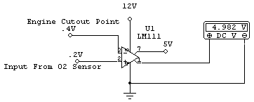

im going to add some more functionality to the voltage clamp you helped me with. so far it has Clamping, and Safety but im adding Air/Fuel mixture control(just a trimmer on the output to drop voltage which makes my car's computer add or decrease the amount of Fuel injected), Additional Injector Control(after making the first voltage clamp i ran into a problem with not having enough fuel past the cutout point, so im adding an injector and controlling it with an added circuit), and Lean Cutout(i want the motor to shutdown if it goes too lean because that will fry my pistons).
i want to use the lm111 to act as a voltage switch, my 02 sensor outputs a voltage from 0V-1V depending on the Air/Fuel Mix. So i want to make 5V go to the output of the voltage clamp if the 02 sensor drops below .4V which will make the computer shut the motor down. I also used another one to deactivate the Lean cutout until the voltage clamp is clamping because while the motor is not running 0V is sent from the 02 sensor so i wouldnt be able to start my motor because 5v would trigger the computer's engine shutdown. I also want to use one to activate the Additional Injector Controller when a user defined voltage is reached And an electronic boost controller that i currently have running off of a pressure switch.
The reason i wanted 4 in one package is because i need one for the 02 cut, one for the extra injector, one for activating the 02 cut, and one for the boost controller; and each one needs a different voltage setting to switch at. so having it all on one chip would make things more compact
As I recall, the LM111/211/311 has an open-collector output and requires a pull-up resistor to achieve standard logical output unless your application is to pull one side of a high-connected load to ground to turn it on. Your diagram had no such object connected to the output. And shame on any circuit simulator that indicated such an output without proper pull-up.

Yes it Requires a Pull Up Resistor on the Output and Maximum Dissipation is 500 mW.
Yes, You can do this, but this is max. dissipation. The required (always higher) resistor value depend from following circuit. E.g. need a relay as output device with driver transistor. The resistor give only base current for transistor, so the comparator dissipation remain low.
