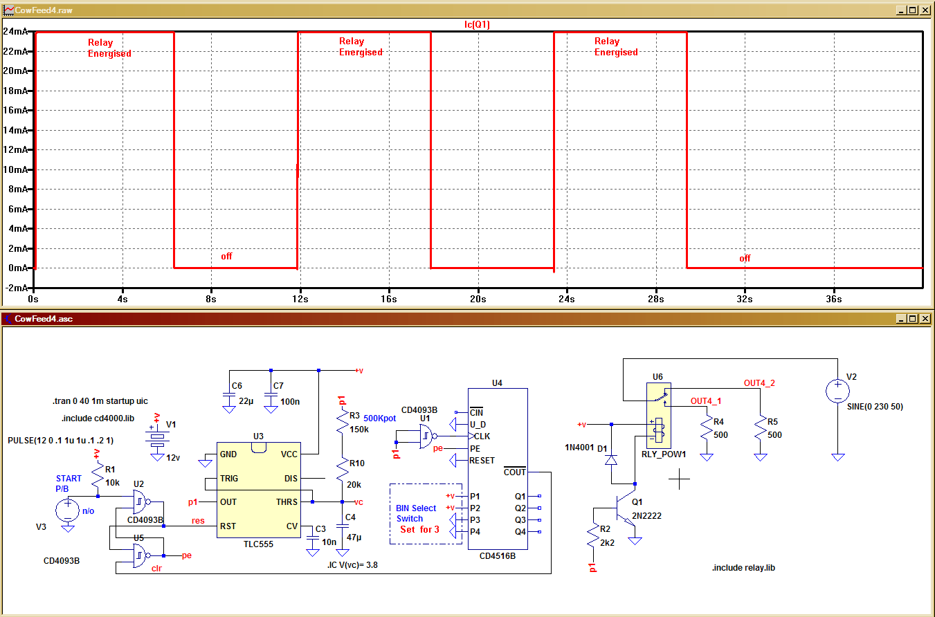

I want it to (once the button has been pressed) energise for 6 seconds (relay on) then de-energise for 6 seconds, then depending on how many ON pulses I want continue until the preset figure is reached then just go to the OFF state again.
Thanks for all your help -
This will give an equal On/Off period for the Relay.
Use a N/O push switch connected as shown on the left of the drawing to start the cycle

@Eric
I leave you to answer the OP's questions.
Note: The DIS output of the 555 is shown unconnected (so the 555 only gives one pulse as it stands). Also, shouldn't the CIN input of the counter be grounded?

ALL the ground 'triangles' are connected to the 0V line.
The p1 in RED is linked to all the other p1 RED's

hi alec,
That method of connecting with the top of the timing resistor connected back to to the output pin is common practice, it gives close to a 50:50 mark/space output.
If required you can add a 10K from the DIS to +V and use it as a secondary output.
I will look at CIN , never had a problem in practice.???
Oops, mea culpa. I had it connected to V+.:eek:
I see in the sim you've got the .ic directive which has the effect of making the first pulse width the same as for following pulses. In reality, though the width of the first pulse is ~8.8 secs when the following pulses are 6 sec. Bonus for the cows!

After consideration I think it would be prudent to connect CIN to 0V, lets have belt and braces for the Cows.!!:rolleyes:
hi Mark,
Connect CIN pin on the CD4516 to 0V , another ground triangle,!

Checked the actual circuit on a BB, it works fine.

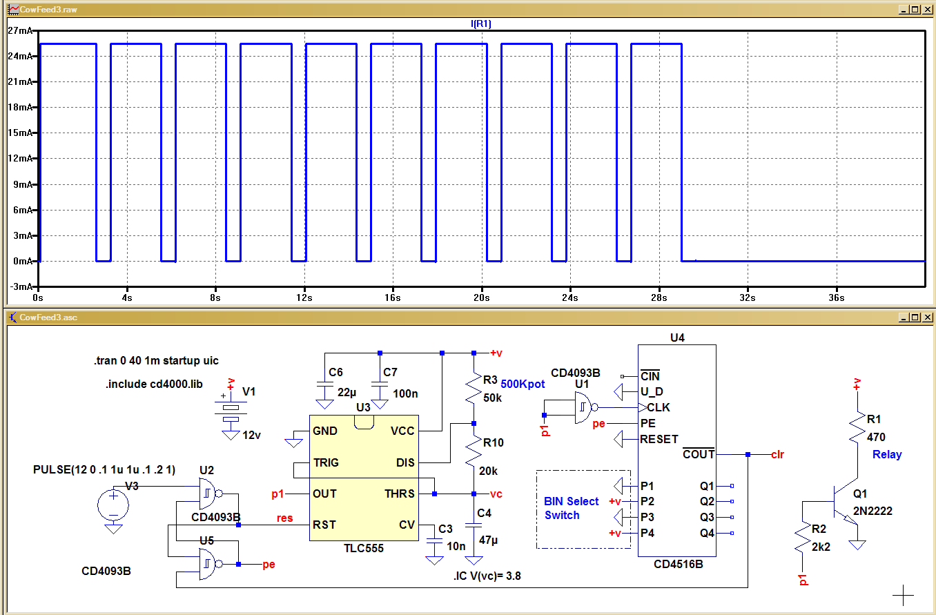

Help again if possible?
Ive made it in yenka?
Can you see if I've made an obvious mistake - as I cant get it to work
Thank you again for the help so far!
  • Feeder circuit Yenka.doc
Ive managed to get it to count up to 15 and then stop, but cant get it to stop at any of the other preset values, between 0 & 15
Hi
Depending upon which BIN switch type you decide to use, you will require resistor pull ups or downs on the parallel inputs to the 4516... Let me know.?
I will look at your simulation in detail, BUT at first look you have the 4516 LD and CE wired wrong.!
The circuit is working on my bench on a BB OK.
