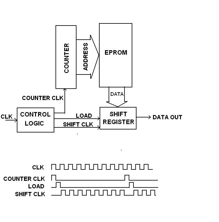

Now, i want to take data from EEPROM, but i don't display it. I want to display each bit of byte.Example, if i receive a byte="11010101", i want to display bit0='1',bit1='0', bit2='1' and so on, serially.
But i don't know.
Can you help me more?
Thank again.
In order to display the data of the EPROM serially you need a shift register with parallel load to load the data of the EPROM in and a control logic circuit to generate the load pulse for the shift register , address counter CLK and shift register clk . The attached figure shows a block diagram and timing diagram of the system

Hi
Try to write VHDL program for each module of block diagram separately and create a schematic block for it and after that use the schematic editor to interconnect the blocks. Now you have the code for the counter and the buffer try to create a schematic block for them. Use the same procedure to write a VHDL module for the shift register and the control logic module and i will help you
Kamal daniel
It depend on the design of the control logic block you can use the CLK and shift CLK from the same source

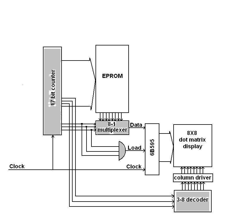

I want to use CPLD (in VHDL) to scan matrix led.
But I don't know. Can you post for a simple example: display "A" character in a matrix led 8x8
Thanks a lot!
It can't be done by CPLD alone you need a memory (EPROM) to store the character data in . I suggest you design it from standard IC first and then implement it in VHDL
yes, i use a EEPROM to store data, then I use cpld to take them. I use 6B595 to shift data from CPLD. Finally, i want to display them on matrix led (8x8)
Can you help me again?
Thanks a lot.
The attached figure shows the block diagram of a CPLD based 8x8 LED matrix display.The gray blocks of the figure must be written in VHDL.In this figure I'm using 8to1 multiplexer to convert parallel data of the EPROM to serial because it doesn't need any control signal. Also I'm using 3to8 line decoder as a column select. In the previous posts i send to you VHDL code of 14bit counter please modify it to 17bit counter as shown in the figure. The following is the VHDL code for the 8to1 multiplexer, 3to8 line decoder, and 3input AND gate
